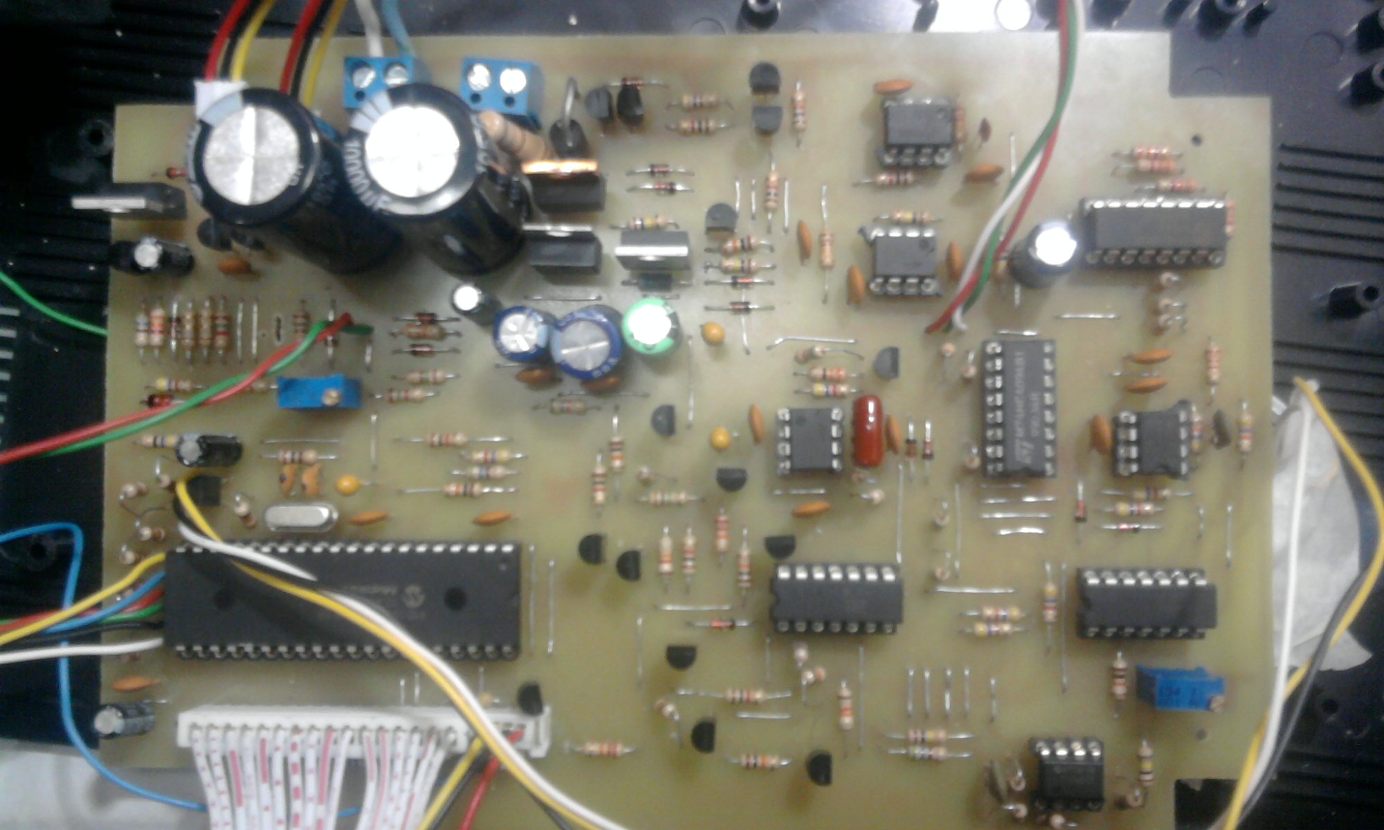

      • HI friends
        I have one problem about Calibration of signal coil. and i Get Video of this problem
        Its not correct Exponential . and i have Horizontal line in nether of GLCD.
        please help me to solve this problem . the threshold sound is in 49 and it very low.

            • I think there is problem of fuse configuration settings...what programmer did you use?

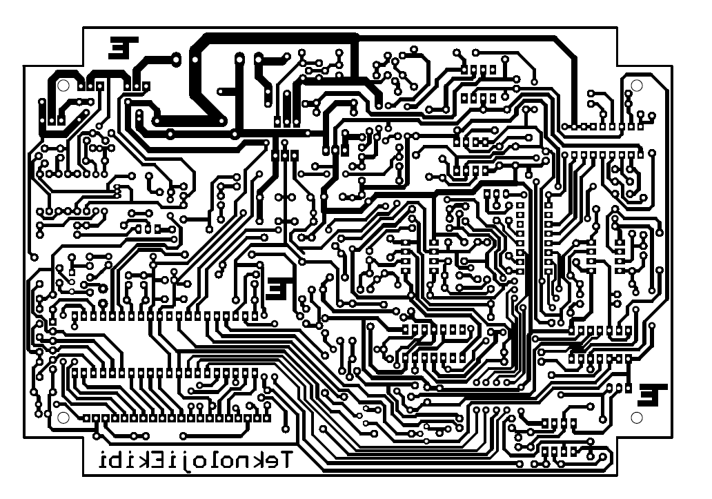

                    • Originally posted by jap View Post
                      Hi hadi-dindar
                      -see rar
                      -read reply#356--->part 4
                      Full wishes for the success to complete
                      best time
                      j.
                      hi
                      the pass is jap
                      • thank you for reply.
                        but part4 in reply#356 about glcd jap/
                        • Originally posted by hadi-dindar View Post
                          Hi hadi-dindar
                          -for -read reply#356--->part 4,,,,,Previous defect.
                          -for new defect,,,,test T9,T10,T11,Q6,D4
                          -test Q3,Q4,D6,,Notable: Q3 is Partial damage from extreme heat...attention!!!
                          best time
                          j.
                          • Hi jap
                            I made my PI v3 but I have many problem....I not find the +5v in regulator 7805 .the regulator is output 5v and good but when I weld in the PCB his give only 0.34V
                            and I not understand what the position for Transistors 2n2097 and the bs 250
                            I have used this type of PI V3 ...but I have found different picture and solutions
                            please help me Jap for resolved these problem
                            • I have resolved the problem is the connection of GLCD
                              the type of GLCD is 12868a ....But my problem now is the IRF 740 so warm . What solutions????
                              Cordially
                              Nicolas
                              • Hi Nicolas
                                -Remove all the components which depend on the +5v like glcd,pic,4094
                                Then measure +5v on out of 7805 ,,,In order to determine Is 7805 or not Mistake.
                                - 2n2097 180-degree wrapped
                                - bs 250 Keep
