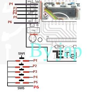

                        • I do not have the amount of the size of the coil inductance, you tell me the five key specific methods of operation, is not my method of operation does not, thank you
                          • Hi liudengyuan
                            If you coil do not agree specification will write this[can not be detected] - because the device is very sensitive there may affects on coil,In order to reduce the effects ,the coil is lifted high enough distance
                            -SW1=TUNE , SW2=DOWN , SW3=UP , SW4=ESC , SW5=ENTER
                            best time
                            j.Click image for larger version
