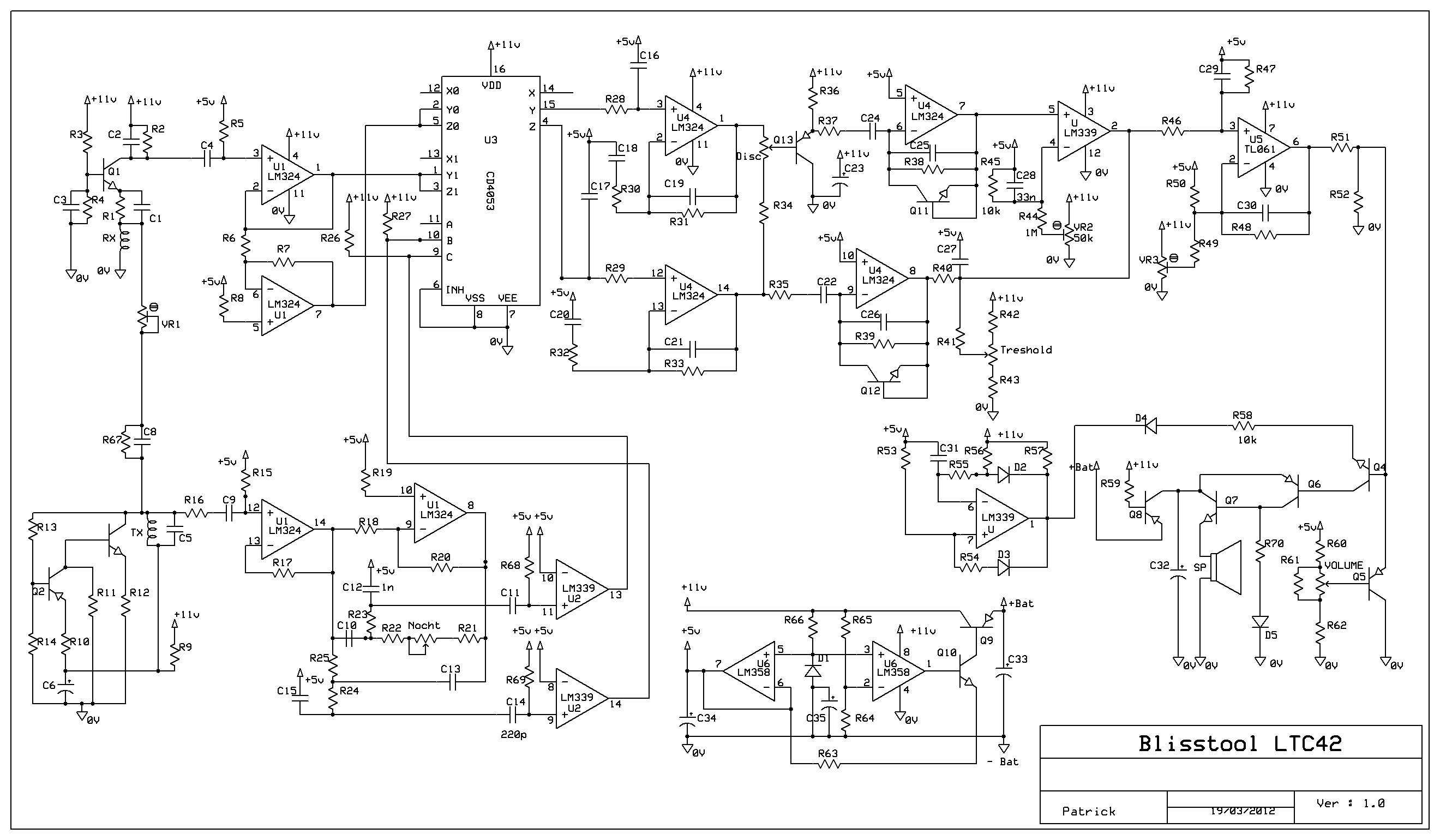

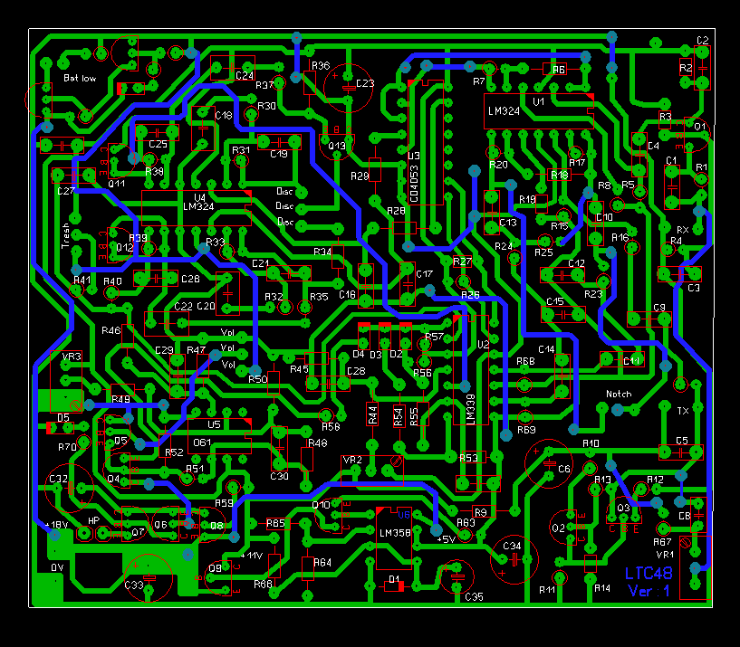

    This is only a proposal as it is impossible to see the tracks below components.

      Good work. C35 is incorrect on cct diagram. Diode D1 will be a zener, 5V1, probably.C17 error connection. U3 pins 11,12,13,14 will all be grounded, I think.

                The +5V supply is obviously used as a virtual ground, it might make more sense to re-label +5V as 0V, +11V as +5V, and 0V as -5V. Hopefully you understand what I mean there.
                  Please part list and coil data

                    I started drawing the TX MAGNUM (11.2 v and 0v)
                      Exact: C35 is on pin 5 of U6 and D1 is a zener.
                      But C17 is good (5v is ground for you)
                      I will correct.

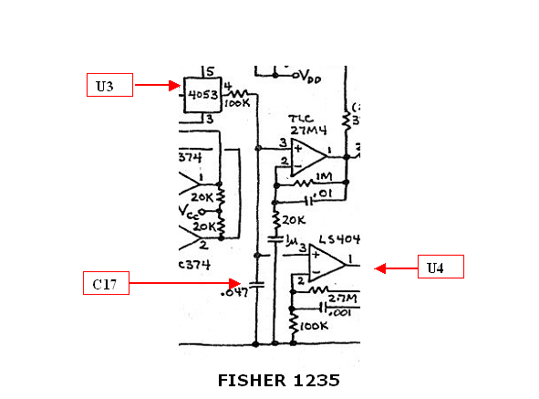

                        The other end of C17 is wrong - goes to U4. Also Q11,Q12 look wrongly connected.

                          good work, please more details,
                          partlist, corrected pcb etc.
                            The same as F1235
                              Boy, you're hard work...... the bottom end of C4 should go to the input of the opamp. On your circuit IT DOES NOT.
