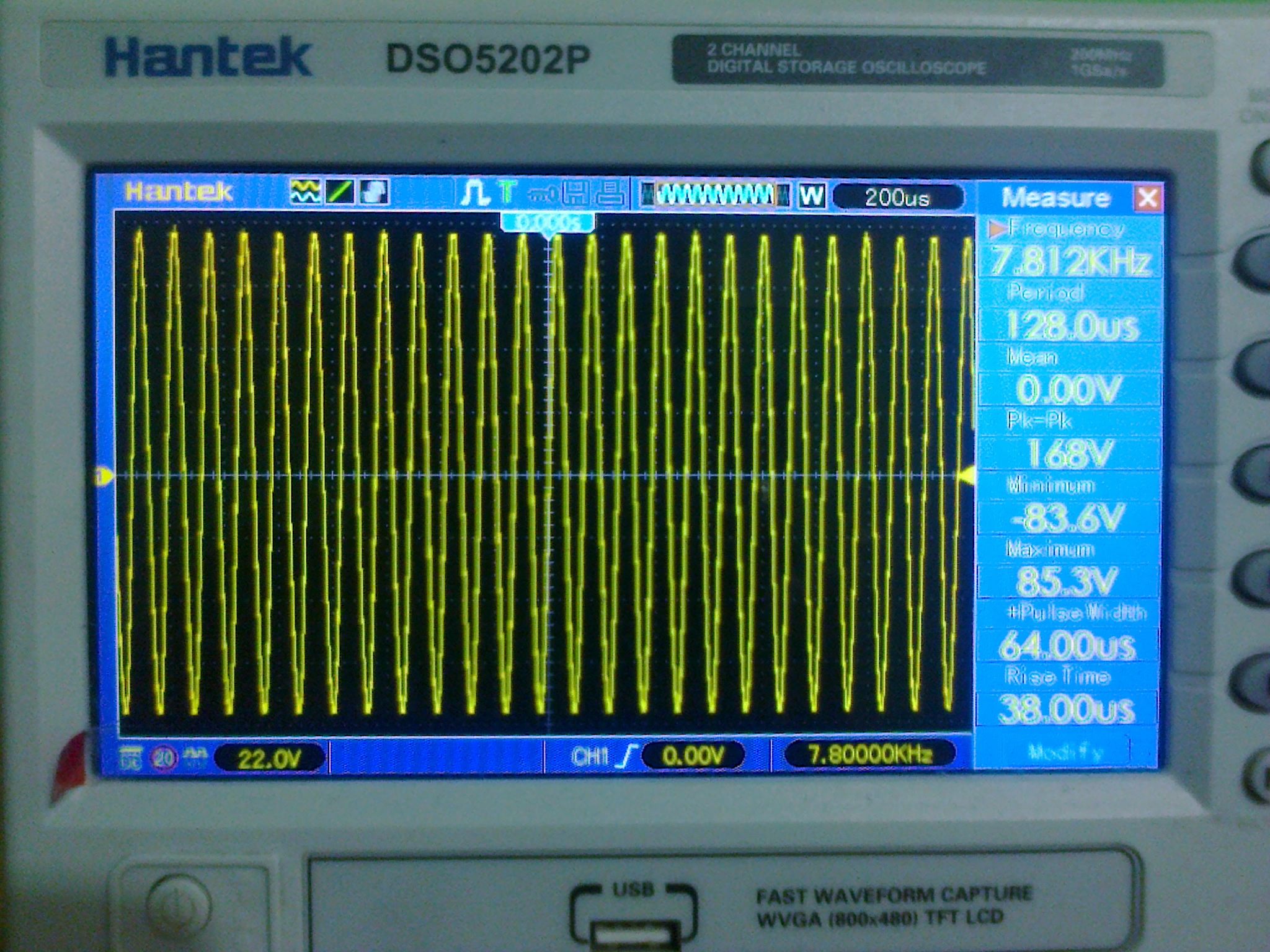

    Hi Marty
    I have tried different ferrite rods, even from PC power supply. Those little rods are good for space saving but if you want better sensitivity use radio ferrite. It has 8-10mm diameter and at least 5cm long so you can put on 400-500 turns. The frequency will change a lot. I have made coils with 7.8kHz and 14.5kHz, but if you want you can change the oscillator capacitors also, I had 470pf and 10nf capacitors at hand. Its very tolerant on coils.

      • #63
        I think shape is not so important here, but inductance is more. This detector is a voltage drop sensor, as metalic object approach the coil its quality factor drops so the oscillators voltage will also drop. Now there is is MCP602 which is used as a comparator and it turns on the Piezzo because the voltages on its inputs are unequal. The trimmer pot is for setting the reference voltage for the comparing. It work with almost any coil, use what you can and what you have the oscillator cant see what you hook up to it, it will be happy to work!

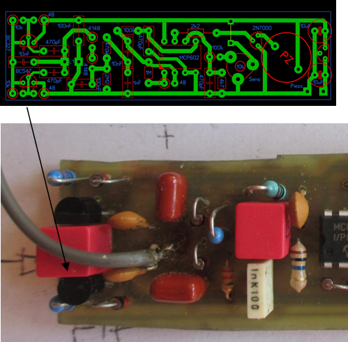

                • #68
                  Hiya Nandor,,,,Which is the correct Orientation of the BC547?,,,On your PCB it is the opposite way to the Sprint layout,,,Thanks, Regards, Marty
                  • #69
                    Yes, because it has reverse pins. I always check with Multimeter In the past had problems with reverse pins, so I learned not to forget to use the multimeter first, for used parts even more important.

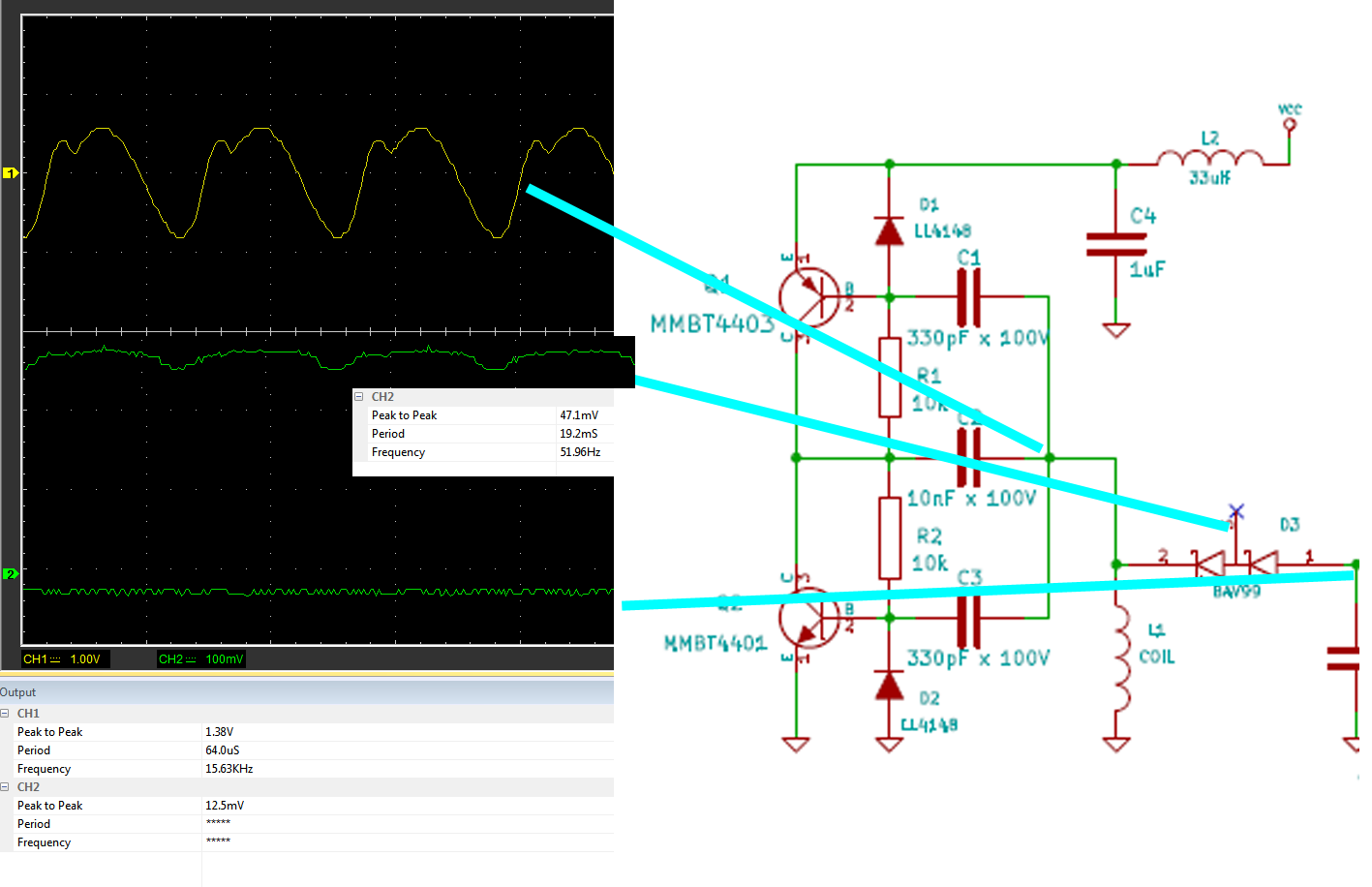

                          • #73
                            Hi can anyone help me? I tried this circuit but I have some problems, after bav99 (two 4148 in series) my signal is continuous, as per attached image.
                            coil is made with 60mm x 10mm ferrite, 425 turns d=0,315 enameled
                            I'm using 2n3904/6 instead 4403/1
                            • #74
                              Hi
                              Can you post a good quality image of your pcb? It would be useful.
                              • #75
                                for now i just using a breadboard.. I'm just studing the circuit... could be this the problem?..
