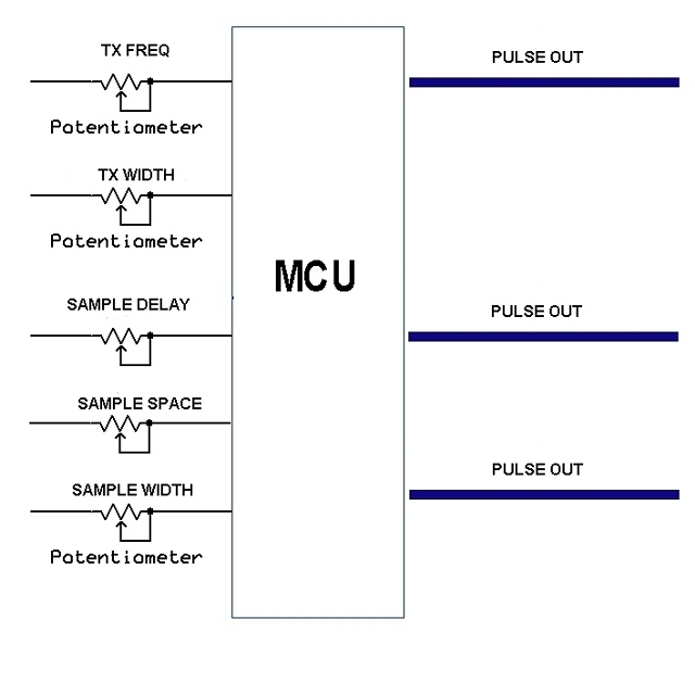

Can we develop a new detector..?
    Pulse can you write software for PI detector ?
    What chips are you useing, can the TX freq (100-500 pps)and pulse width , and sample delay and pulse widths be altered with pots ?

                              Hi friends,
                              thank you all, i am using freescale for todays. i want to make a digital pulse detector. Also, if we will make a vlf detector, we wil need a sinus osc. Could you give me some advice for mcu control sinus osc.
                              6666, yes I can write. I am using freescle and arm.
                                It is easy, especially if you do not need to tune frequency continually. You'll synthesize it using some even number of steps (NRZ). In such case you'll have a zero crossing a well defined one. You may also adjust granularity of steps in a way that they step at some nice phi values, say 7° etc. Thus you'll have no problem sampling Rx at proper times.
                                This approach generates harmonics, but who cares? They'll be nicely wiped out by the tank capacitance. Using only a few steps you can effectively reduce harmonics up to, say, 5th or 7th to zero by adjusting step values alone, and your drivers need not be in linear regime at all. And it will swing from rail to rail.
                                Using DDS is a possibility, but expensive one.
