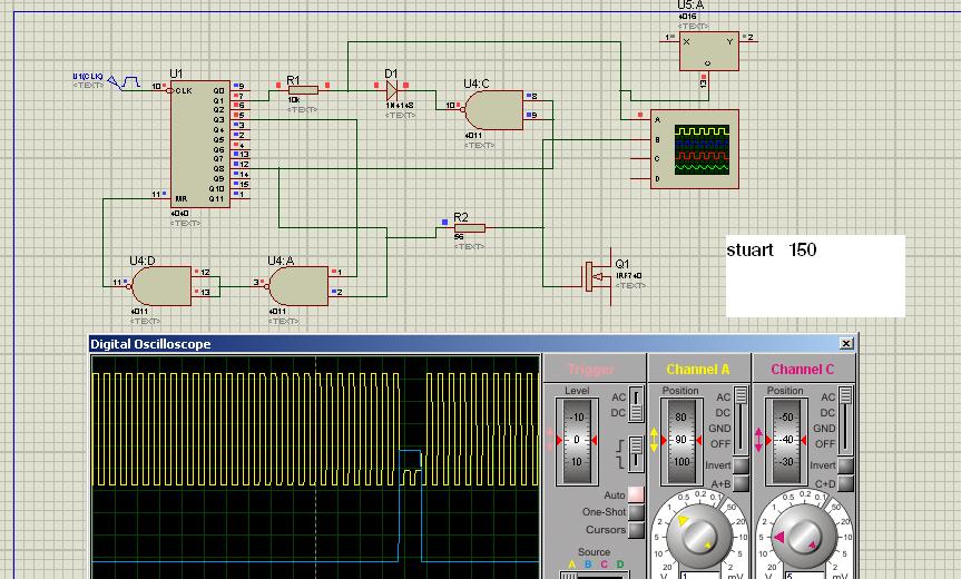

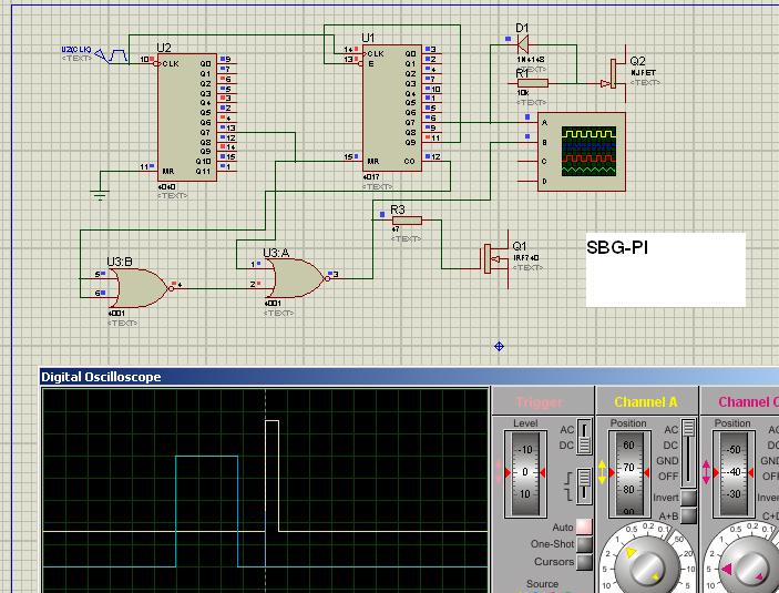

  • Plagiarist sinco 1 write-It says that sasho scheme design mean that it was his scheme? This is an old scheme stuart.
    Here's how work two schematic. Is identical?
ID:	333673Click image for larger version

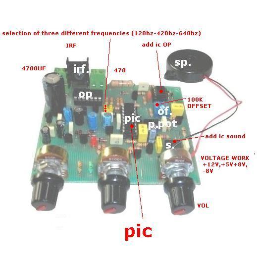

      I have a question about Vandal 2: Where is the switch for the selection of three different frequencies (120hz-420hz-640hz)?
      The figure shows: terminals Power, terminals for the coil, three potentiometers and piezo.

                          • hello
                            i need more info for adjusting vandal 2
                            i made coil 36cm from 0,5mm2 litz wire 16turns
                            but coils rings very loud so i think coil damping is not right
                            and i cant adjust this coil to give good results
                            i will try to rebuild coil with massive core wire 0,6mm 16-18 turns 36cm
                            but setup is unclear at moment
                            the are 3 pots
                            sens
                            tune
                            fine tune
                            before i set onboard offset trimmer to +1,5V (or another better working value)
                            where should i set the 3 pots
                            should i turn them all counterclockwise in mid position or where else?
                            for a 1m square coil i use 10turns of 1,5mm2 litz wire (audio loudspeaker cable)
                            results are good 0,75l alu can at 1,20m in air
                            but for smaller coils i think massive core cable or magnet copper wire is better
