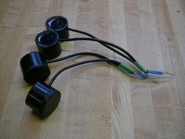

    Re: Transducer Photo
    [img]../images/Transducers1x.jpg[/img]
    I'll give this a try ...

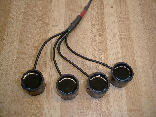

      Re: Transducer Photo #2
      [img]../images/Transducers2x.jpg[/img]
      This is a shot after all the shrink wrap was done. Nice work Garrett!!!!

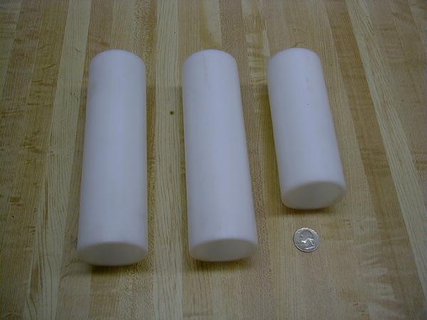

        Re: Fish Sections
        [img]../images/Fish Sections1x.jpg[/img]
        This photo shows the three sections of the fish which includes an 8" tow section, and 8" transducer array section, and a 6" tail section. We used 2 3/8" white delrin pipe. It was cut on a chop saw ... band saws do NOT make near as clean (straight) a cut.
        Patrick

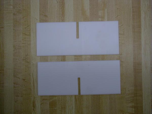

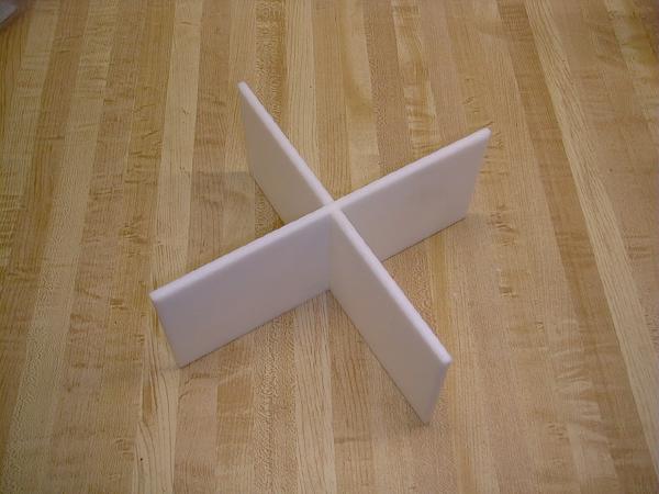

          Re: Tail Section
          [img]../images/Wings1x.jpg[/img]
          This photo shows the 2 wing sections with center cuts. We used 1/4" white delrin flat stock. We also used a router to soften the edges (cannot be seen).
          Patrick
            Re: Tail Section
            [img]../images/Wings2x.jpg[/img]
            This photo shows the 2 wing sections that when placed on top of each other makes the "tail section".
            Tools used ... table saw and router (to soften edges).
            Patrick
              I should mention that the Lowrance PD-W 192 kHz (20 degree beam) transducers come with ears that must be removed to bond the transducers together.
              You might be able to see the marks on the top of the transducers where the ears were cut off.
              I did this by putting them in a vice (do not clamp hard for obvious reasons) and used a small hack saw to cut them off. I also tried a Dremel tool, but it was slow and did not do as good as a job.
              Patrick
                Re: Fish Sections
                [img]../images/Fish Sections1x1.jpg[/img]
                Try it again ...
                  Re: Fish Sections
                  For some reason beyond me this photo is not coming through.
                  If you are interested, you can view it on the Yahoo page.
                  Time to get some sleep.
                  Patrick
                    Re: Fish Sections
                    [img]../images/FishSections1x.jpg[/img]
                    The sections ...
