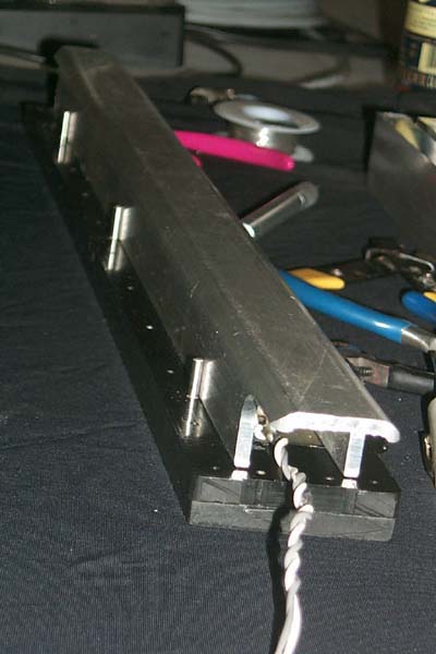

      When cured, I remove the aluminum and leave the elements and urethane in the window mold. Now I wire the backside.

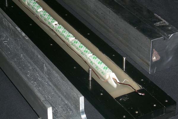

        Ready to put the ducers housing on.

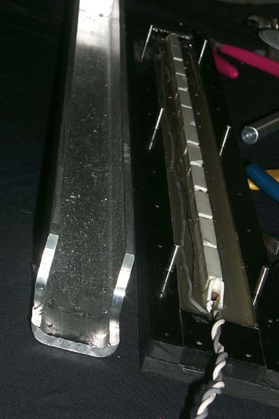

          I’ll rap the hole ducer with heat shrink tape and than pore the urethane.
