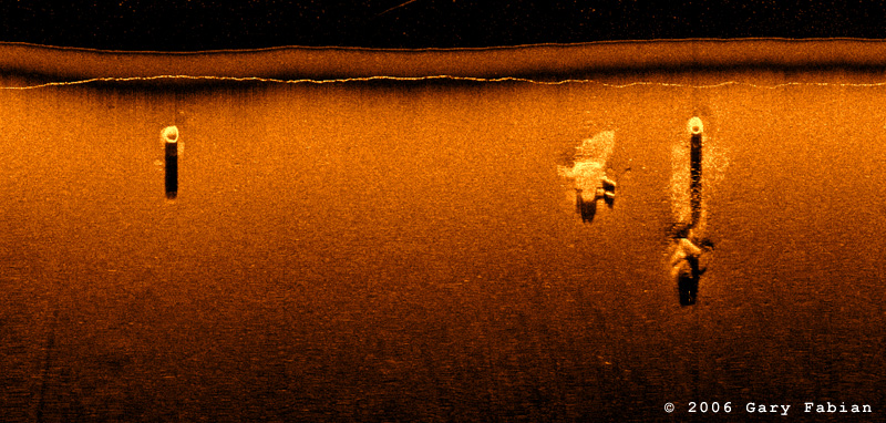

    Attached are two recent scans off the coast of California. These were recorded on a Lowrance LCX-110C and the screen captures were taken using the Lowrance Sonar Viewer PC application. Sonar Viewer is a free download from the Lowrance website.
    This first scan is a group of discarded sections of sewer pipe. These sections are 12 ft long and 8 ft in diameter. Note that two of the sections are standing upright. You can clearly see the upper ends of each pipe as well as their distinct acoustic shadow. One pipe section is badly broken and the target at lower right is one pipe laying atop another. This was recorded at 220 ft range at 2 knots. 85 ft water depth.

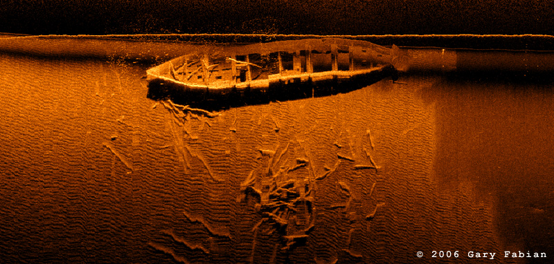

    The second image is a large steel wreck that was intentionally sunk as an artificial reef. You can clearly see the collapsed deck and various openings in the hull. Sand waves are also clearly visible along with concrete rubble that was dumped later on the site. Just aft of the stern you can see the permanent surface buoy and directly beneath it is the mooring block on the bottom. This was recorded at 330 ft range at 2 knots. 130 ft water depth.
    I feel that the quality of these images is comparable to commercial systems costing 10 times as much.

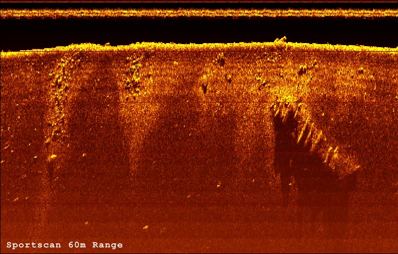

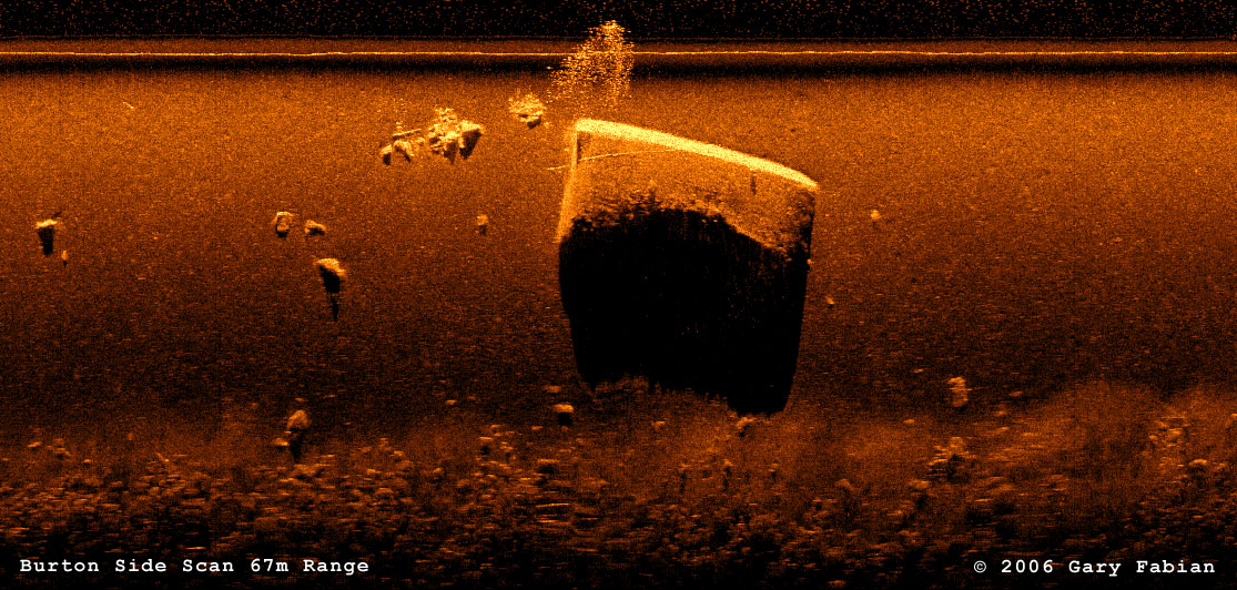

                    Image quality is also important to me and I think the Burton side scan produces a superior image. Attached are screen shots of a 60m Sportscan image of a wreck and a 67m Burton image of an upside down rock barge. Note the anchor chain draped over the barge. You be the judge.

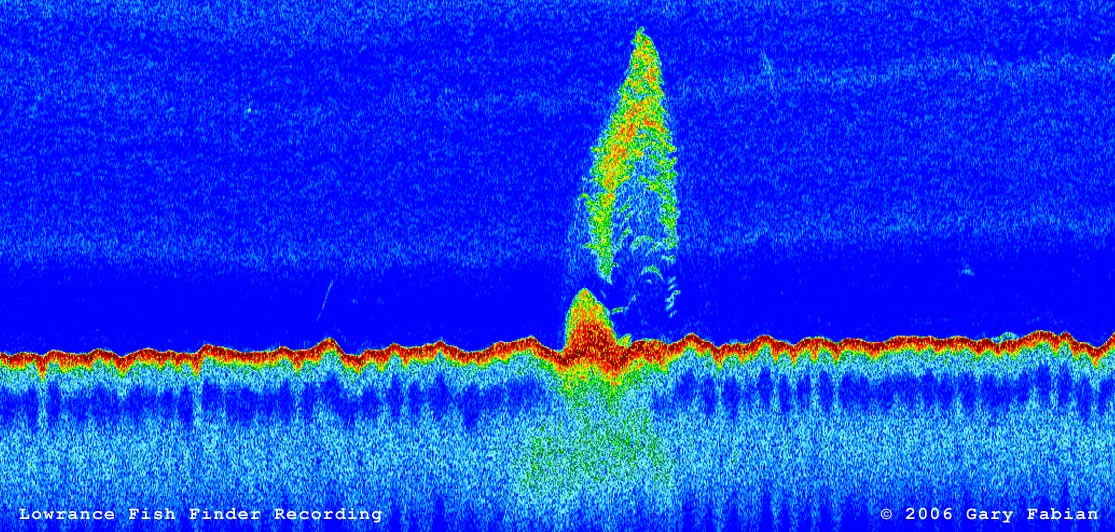

                    One final note is to remember that the Lowrance recorder can still be used as a regular fish finder when not being used for side scanning. Attached is a sample recorded image.

                      Image quality
                      I would not use the sportscan image for any analysis or comparison of image quality. It is a very poor scan. If you look closely at the scan there are wedge(vee) shaped segments of very high detail displayed along the path of the scan. This is a common problem that occurs frequently with SportScan towfish. The towfish is extremely sensitive to weight and balance. If not properly adjusted, the towfish will wobble and zig-zag especially on a short length of cable. Any movement of the towfish is amplified in the signal returns because the transducers are located at the rear of the towfish. Also, it appears there are no target returns beyond 40m or so indicating a towfish alignment problem or more likely the unit is operating on high frequency which is limited to about 40m.

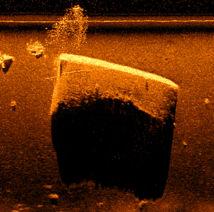

                          I'm quite impressed with the level of detail in my recordings. In the attached close up of the rock barge you can resolve individual fish in the school and you can also see the shadow of the anchor chain on the bottom.

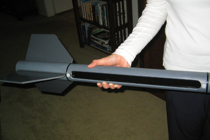

                            Can you send a close picture up of the transducer.
                            Has any body got any experience of hand building them?
                              A close-up of the transducer.
