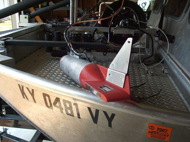

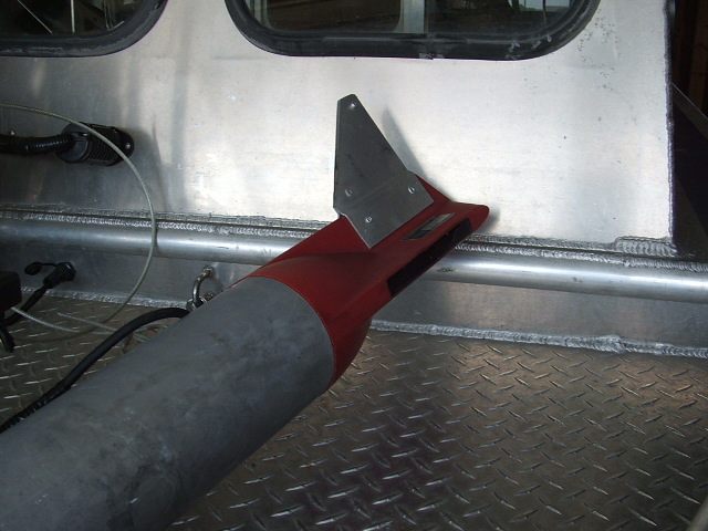

          I have a sportscan that is the same general towfish design. I have added a small aluminum vertical fin that basically extends the existing fin above the body of the fish. This helped dramatically with wobble, especially when cable out was very short. Also, I keep the weight balance where the fish is slightly tail high when in the water.

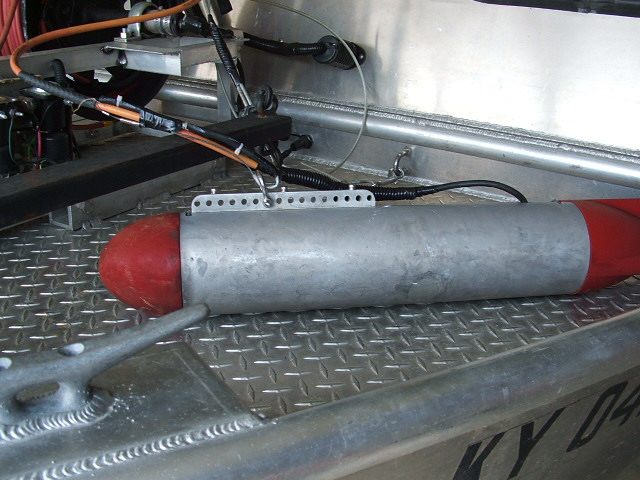

          I think I have about 12-15 pounds of ballast, with all the weight near the front and bottom of the fish. Initially, I had more weight, but when the fish was shallow it tended to "pendulum" port and starboard.
          I am away from my equipment at the moment, but I will take a picture of it later today to give you an idea for a fin. Also, I can confirm the attachment point with the photo.
          Patrick

              The sportscan plastic nosecone is removable, I had assumed the Yellowfin was the same, but maybe it isn't. I also have a bag of lead shot in the nosecone itself.
              All my work is in relatively shallow water and I never use the towfish with more than 30 feet of cable out. Usually, it is with 10-20 feet out.
              Patrick

                  I have attached a few images. Hopefully they will work ok.
                  Patrick

                        What is the metal you used to extend the body? Is it a standard sized pipe?
