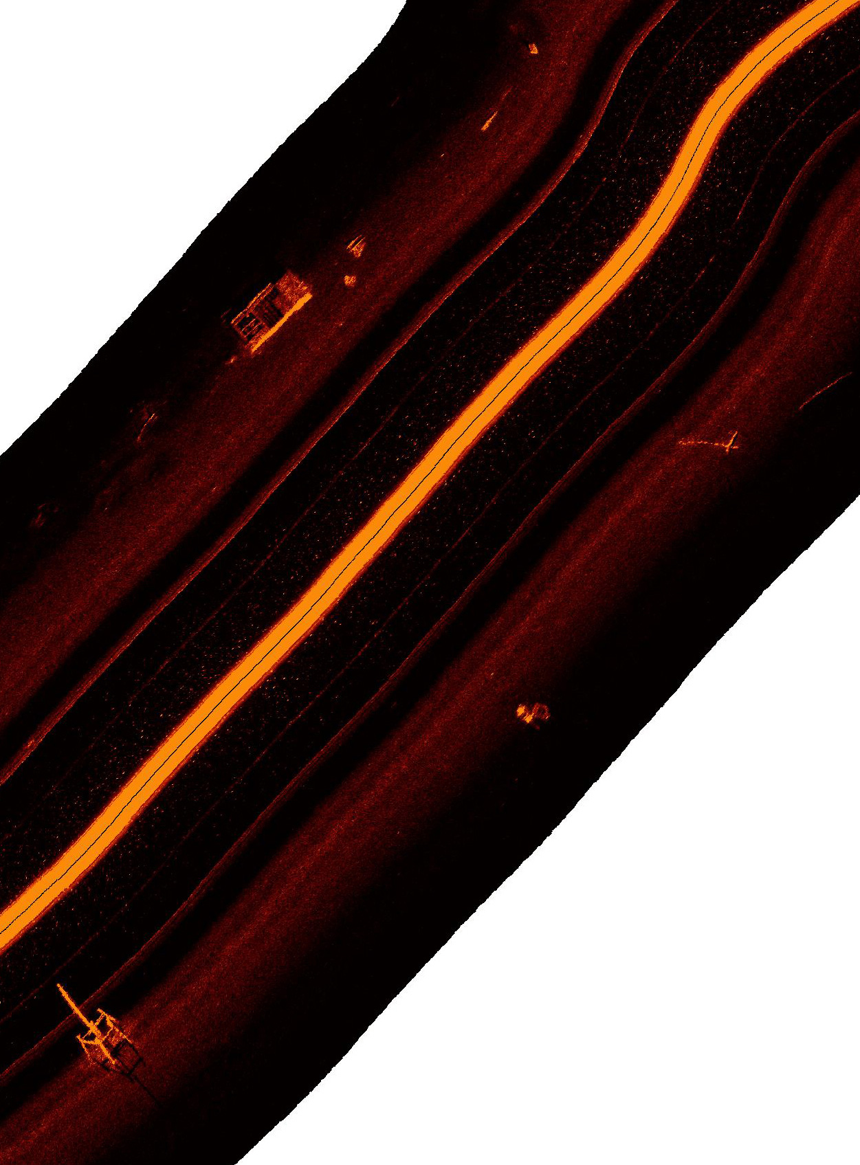

In summing up in my opinion, the Hummingbird is what it says it is, a “side scan” unit, very strong in terrain aspects... Their early version was a technical correct down-scan... Weaker in detailing objects on the ground....
Lowrance structure scan is what it says it is, a “structure scan”... very strong in detailing objects on the ground, (A fictional down-scan based on fact) allot weaker in dealing with terrain aspects.... Ideally one of each solves most problems...
The att image (if this works) while deep for an 800Hkz (sea water 18mtrs) high lights my point...
Generally speaking side-scan loves flat bottoms, no obstacles, allot of open space to work in... Sadly my projects have none of that, steep terrain, rolling hills, 20/40m cliff faces, submerged caves, sinkholes, tall trees, poles, building & bridges... etc, but only down to 50mtrs...
