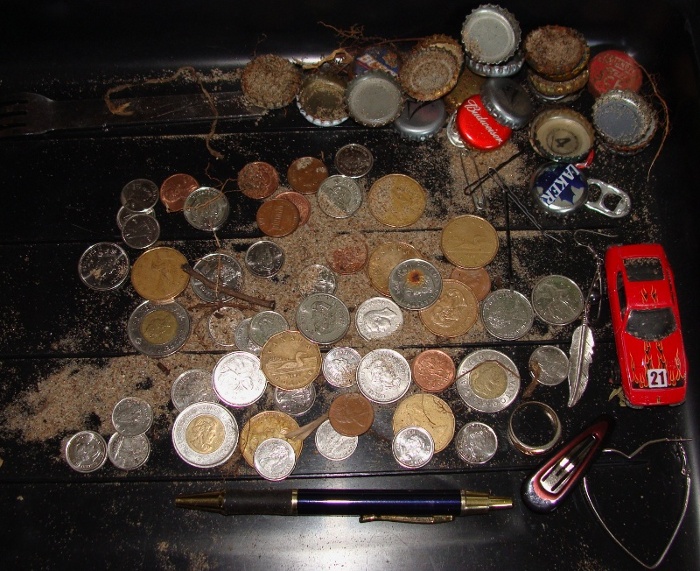

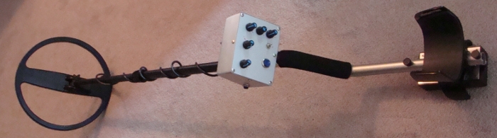

    My home built PI's will give a slight increase in threshold at 36cm when passing a large man's wedding band under the coil air testing. I can not hear this change when hunting in the water or on the beach as the threshold is not 100% steady due to ground conditions that change. But, there are times I might hear it if ground conditions are stable? I haven't actually buried any targets yet to see how deep I can penetrate our local sands which does contain black sands. My water scoop with a magnet attached always has a fuzzball of black sand sticking from it.
    From the way my PI is calibrated, it discriminates out most small foil but, still picks up the small gold rings. I actually like using the PI more than the VLF, hate digging the small foil.
    Next time out I should bury some coins and rings and see how deep the machines will actually detect the target. I don't think any of the coins found today at the beach were over 5"-6" deep. But, did get signals from targets deeper than 12 inches that I did not dig down to as they sounded like larger pcs. of iron. I am not sure how much deeper my PI's will go vs. a higher end VLF machine, haven't had enough actual hunting time on it. I did make a 7" search coil that almost air tests as well as the 10.5 coil pictured. The 7" coil is fun to use but, the 10.5 covers more ground. i am still working on slowing down my swing and keeping a steady rhythm from side to side without stopping at the end of each swing

                            I was hunting a local beach with a CTX-3030 and hit an area with a ton of coins. All nickels and pennies, little or no quarters. I found only one ring - but my first (yea).
                            There were so many targets I looked like a digging fool. I came home and looked at all the coin and realized it is all newer stuff but heavily corroded and coated with a brown coating. I have no use for it - a lot of it even if cleaned would be unusable. So I masked out the pennies on the CTX and went back the next day. Even though masked out I could see the pennies were still there and nickels too. No rings this time. A guy on a forum was saying that the black sand layers there were masking out the rings under them. His surfmaster DF was finding rings. Is this the story or did I just not have the coil over the right spot? (or someone beat me to them that day) With the DF would there be a way to tell a deep target (ring) from one of the shallow pennies?
