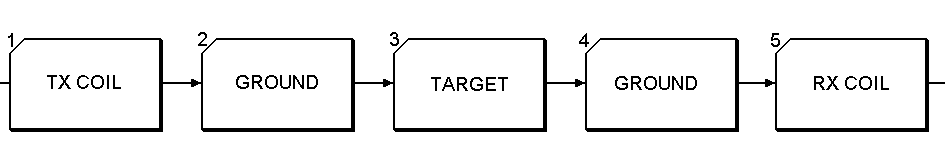

          However timeconstants of conductive soil depend on diameter of TX coil. Using 12'' coil at 14kHz generates too
          strong GND signal, which limits sensitivity. In addition, the conductive soil shifts target phase which distorts
          discrimination. The attached simple block diagram illustrates why discrimination of deep targets is distorted - the energy passes twice depth in ground.
