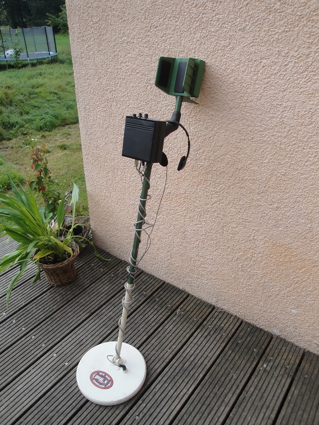

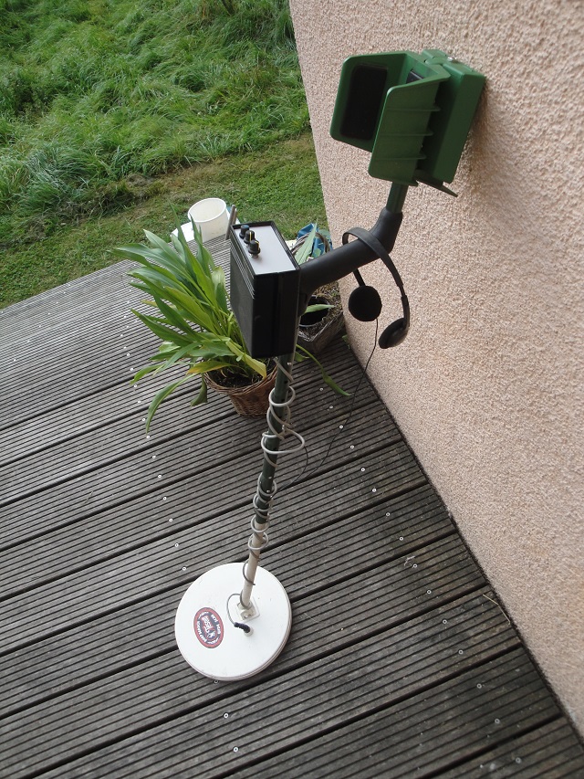

                Do you have any photos of the finished detector?
                Here it is.
Name:	DSC02901 klein.jpg
Name:	DSC02902 klein.jpg
                The stem and batterycase is from the Garrett GTI 2500.
                Greetings
                Michael
