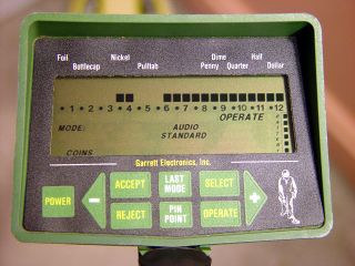

      Here is an image of an Garrett Ultra 1000, which looks similar, except for the image of the man on the right.

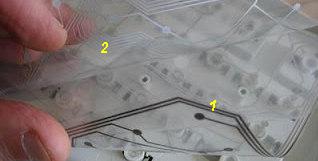

          The unit can be disassembled, but the membrane keyboard is glued into the housing, and has a flexi-pcb as the connector.
          Next time I take it apart I'll post some photos.

                First you need to know what exactly was broken. The thin copper-leads?
                If you know the spot you may connect them again by soldering something over.
                Usually this panel stuff consists of plastic that is glued together.
                If you can get those foils apart you will find the culprit.
                If it's the ribbon cable you should see it directly.

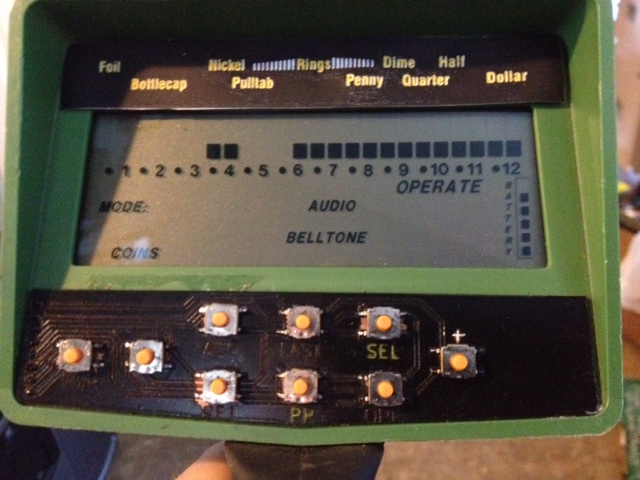

                    Eventually I found some time to examine this detector again. I removed the flexi-keypad, and fitted some tactile switches, which was an horrendously fiddly job. These are the same type used in laptops for the touchpad switches. I drilled a number of holes under the flexible plastic label and epoxied each switch in position, then soldered some 8-wire ribbon cable on the back of the PCB connector. After confirming which pairs of wires operated which function, I wired up the switches appropriately. The only problem I had was with the Select button. Unfortunately there was a mounting pillar in the way that prevented me drilling a hole for the tactile switch, and I was forced to mount it further over on the right-hand side of the panel.
                    Anyway, the bottom line is that it's all working again. The original plastic label is super-glued back in place, and there's enough flexibility to operate the switches underneath. In fact, apart from the misplaced Select button, it's much nicer to use due to the tactile feedback.

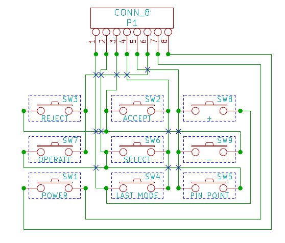

                    In case anyone finds this useful, here's the wiring information for the switches:
                    Ribbon Cable
                    1. Brown
                    2. Red
                    3. Orange
                    4. Yellow
                    5. Green
                    6. Blue
                    7. Purple
                    8. Grey
                    Switches
                    Power = 7,8
                    (-) = 3,5
                    Accept = 3,4
                    Reject = 3,6
                    Last Mode = 1,4
                    PinPoint = 2,5
                    Select = 2,4
                    Operate = 2,6
                    (+) = 1,5
                      I recently had to perform a repair to the keypad on my GTA1000. They are no longer available from Garrett. Here is a schematic of the buttons to go along with what Qiaozhi posted above.

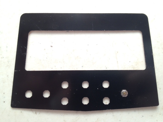

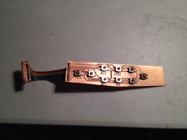

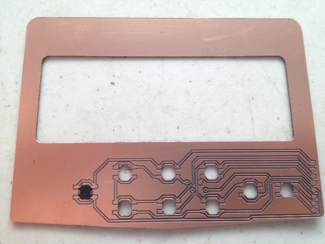

                        I thought I would show my first attempt to repair my GTA1000 with a failed touchpad. I made a small PCB and mounted tactile switches to it. Workes great. Doesn't really look that great however. I have another idea and the parts are ordered. Should be in late this week. If it works, I'll post pics. If not, you'll never see it.

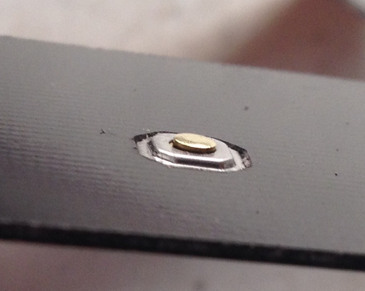

                          Here are a few pictures of my latest attempt to repair my GTA1000 keypad. I wanted to get some small tactile switches and mount them on a PCB. I didn't want to mount them on the PCB but more inside it to make the buttons as flat as possible. I will use adhesive to place the original faceplate decal back on top of the PCB with the tactile switches just sticking out enough to be actuated. I used .032"(.8mm) PCB material and found switches that were not much thicker. The swiches will be surface mounted reverse from normal. I hope to achieve good tactile feel and a factory appearance.

                            Although my GTAx1000 still looks original from the outside, the Select button is not actually under the Select logo. It's over on the right-hand side. Apart from that, it works perfectly. Unfortunately I neglected to take any photos of the finished product.
                              Well, I got all the switches mounted and everything looked good. I decided to add a drop of superglue to keep the switches in place. Bad idea. glue seeped into at least 3 switches and now they dont work. It looks like I will get to do it all again. Joy.
