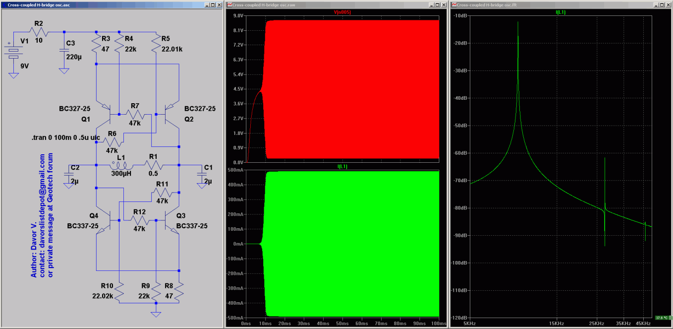

    I think I have a nice contender for the second solution, a balanced oscillator.
    Now about the cross-coupled oscillators. They generally require a center tapped coil (but not in my solution), and they resemble a two transistor multivibrator. Trouble with these is that you must supply DC and it is usually achieved via center tap. I gave it a second thought and concluded that the center tap is not required if the cross-coupled drivers are configured in H-bridge. It fixes the DC problem. Additionally, if the capacitor is done "center tapped" I reap the fruits of the balanced design WITHOUT A CENTER TAP. It additionally cancels a 2nd harmonic.
    Stability of this design relies on the stability of the rails voltage. Power consumption is very little, and the best of all - it works happily with large resistance coils as well.
    IMHO any serious VLF design should have a balanced Tx source.
    Here it goes:
    I tried some sims with L at 300uH and caps at 2u with corrections to R3 and R8 to 33ohm, and it works of course. Coil current is ~1App, no 2nd harmonic and 3rd harmonic lower than -50dBc. Nice.
      Qtx = ???

          Cross-coupled oscillators are a logical step in VLF metal detectors, and they are extremely well documented in other walks of the art, mainly VHF to microwave VCOs. They are mostly built using mosfets, and their superior phase noise is very well documented. In fact there are at least two models explaining their good behaviour. Configuring them in a H-bridge was kind of obvious. True, I did not find them in this configuration yet, but most probably someone else already did that. Even if this is new it still falls under the "obvious" category.

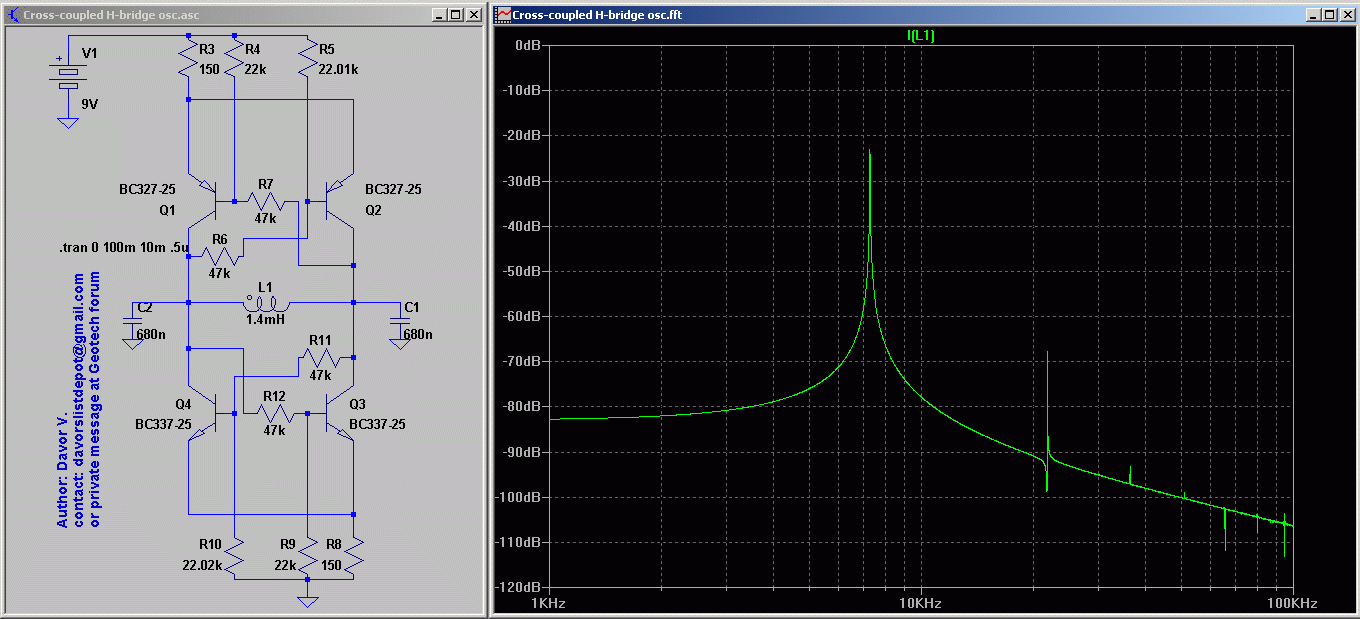

          Try the above attached LTspice sim and see for yourself. It is extremely flexible. The coil that I put in the schematic has a realistic resistance for the coil of that size, in fact I used measured values of my own coil. Using a 4 times lower inductance means half the turns, and a double wire cross section, e.g. a quarter resistance, so 300uH is equally feasible. If coil Q is a problem, just lower the R3 and R8 to increase overall gain and you get a nice rail to rail oscillation again.
          Below is a solution with all lumped elements with the coil resistance in series with the coil, and without the initial DC point solution (as if you applied voltage at 0s, and it was 0 before that). It draws about 12mA for ~1App output. Try the zipped sim
            Qtx ~ 30
            very bad!
            Qtx < 7
              Bad what? Please elaborate.
