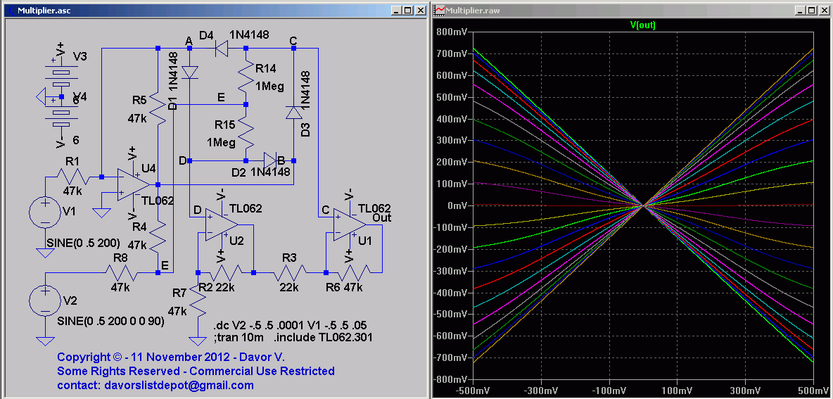

    As announced at 4 quadrant receiver topic, I invented a simple and DC accurate analogue multiplier. 3 opamps, 4 diodes of the most common kind, and several resistors. It is arguable that I could get some Gilbert cell chip for the purpose, but those are not DC accurate, and for sure opamps are much cheaper and common.
    It came to me as an epiphany. It happens to me sometimes when I'm relaxed and do what I like ...as opposed to working under pressure.
    There are 2 voltage inputs, of course, and V1 would correspond to a LO input because it saturates at high input levels. V2 would be a signal input. U1 and U2 are an instrumentation amplifier, and the rest ... you'll recognise a diode ring. There is also some clever play with balances in diagonals, and a result is ... not perfect, but surely good enough.
    I'm sure someone else would spend the next at least 6 months in patenting this idea. I on the other hand am not at all impressed by patents, and I'm appalled by patent trolls. So it is published here and you are free to enjoy it - unless you are a patent troll.

    I'd never seen such implementation of multiplier .... the only drawback what I see is low speed due to big resistor values in the signal chain .
    But for MD purposes it can be enough ...
      Yes, it is high impedance all over. These can be scaled down, but the V1 input goes into saturation sooner. I wanted a DC accurate amplifier for 1Vpp at inputs, and this is precisely it.
      Surely some other diodes would perform different, but one of my goals was to use only non-specialty never-to-fall-into-obsolence garden variety components available in Goundam near Timbuktu if necessary, and again - this is precisely it.

        How about tempco (temperature dependency)? I think, this is the crucial point in all analog multipliers.

          Take a closer look, and you'll see - it is the same component that does log and anti-log functions, so temperature does not matter that much.
