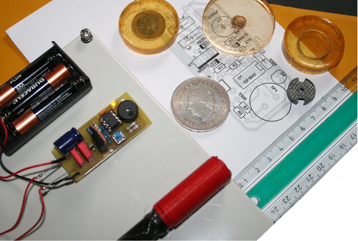

          Hello,
          Made the pcb, I did not have al the parts.......used a IRF730 , and some high volts diode and a 470 nf and 1000uF cap.
          The coil is the red wire on a pvc tube with a ferrit from some 4 cm it in.
          Sens for the coins some 3cm for the small gold coin and 5 cm for the large silver coin, the ferrit gives also some detection.
          Nice as a pinpointer..? Click image for larger version
          ...the ferrit core is also detected..!
          Current was some 20 mA at 4.5 volts
          Best regards
          Ap

            Hello!
            Very good job AP! I't is good to see.
            Do you consider that it is detecting ferrite, good or bad thing? In theory it should not detect ferrite core very well.
            Teemo
            • #51
              IRF730 may not to be the best MOSFET for the job. According to the datasheet it needs pretty high gate to source voltage. So it is probably limiting current.

                Hello Teemo,
                Yes the current is only some 20mA..I like that, with your fet how high is then the current ?
                The detected ferrite is giving more sound when it is removed from the coil, can it be that I have the wrong working freq.?
                Found that the circuit can use many coils.. it works at many different one's. The last I used (on the photo) has a ferrite in it, by shifting that ferrite different uH 's can be made ,the circuit alway's works..
                It is a nice circuit and if it can reject the ferrite,( ground effect) it is a good pinpointer, again thank for sharing !
                I have not much testing done, the room were my scope stands is not heated...
                Best regards,
                Ap

                  Thanks Ap,
                  With my mosfet K2134 average current draw is about 64mA.
                  • #54
                    Hello
                    I made new experimental version of firmware code, asm and hex available: http://digiwood.ee/en/metal-detector/firmware-page
                    It now uses frequency information also. Much less reaction to the ferrite.
                    AP, your current consumption is so small that, it is a miracle it works. 20mA, Only the LED takes half of that, and other half goes to the microcontroller and coil. This new version code might not work with that mosfet.
                    All the best,
                    Teemo

                      Hello Teemo
                      Nice! a update from the software, next week hope to test it. The led I used is a low current one, I think only some 2mA..
                      Well see if I have an other fet.....from the IFR730 I have plenty, so it is a first to use in experiments..
                      Best regards
                      Ap
