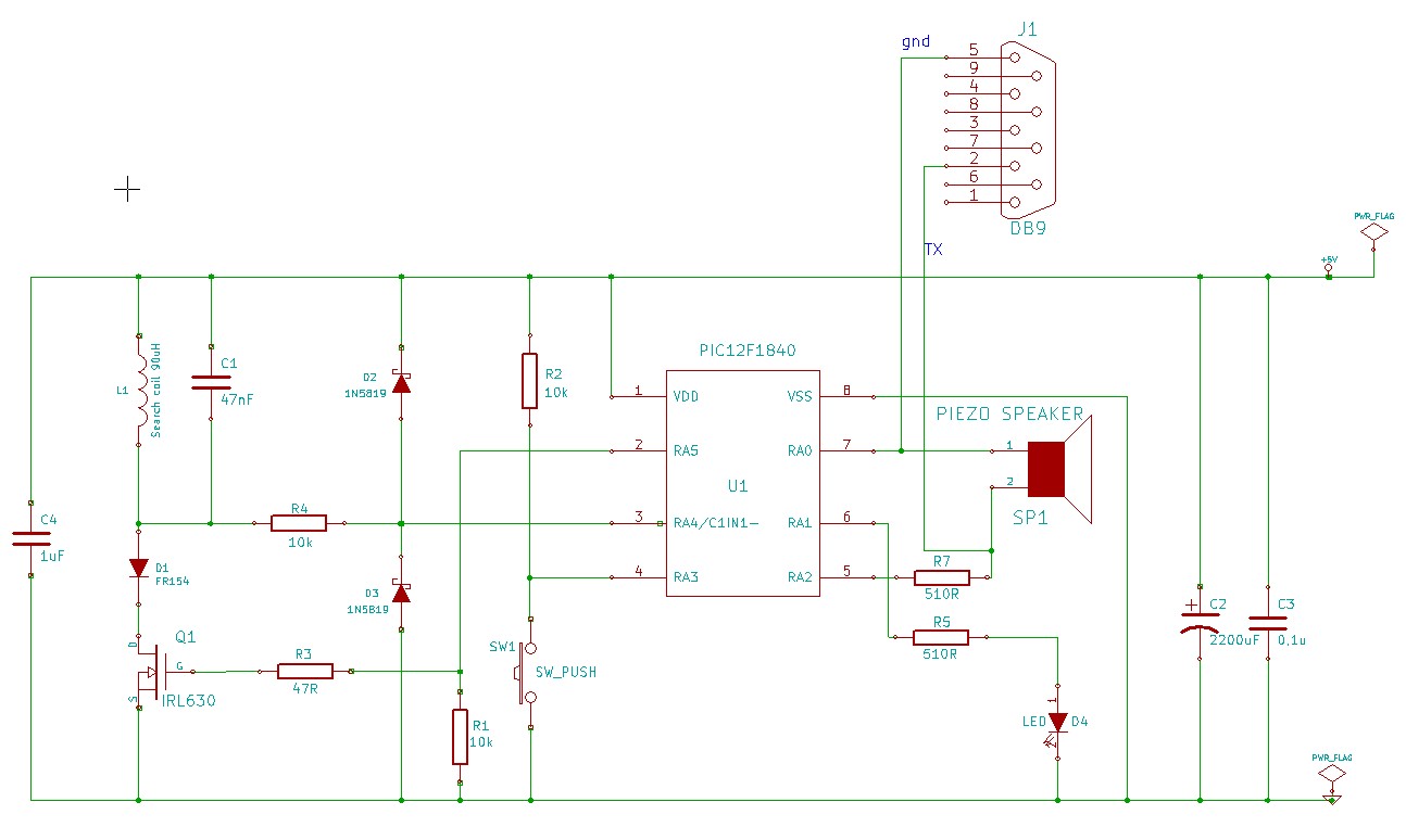

        Connecting to PC
        Hello everybody!
        I have made new special firmware for my project. This time it is for connecting the circuit to computer.
        Link to the page:http://digiwood.ee/en/metal-detector...ter-connection
        I also attach connection schematic and firmware directly to here.Click image for larger version

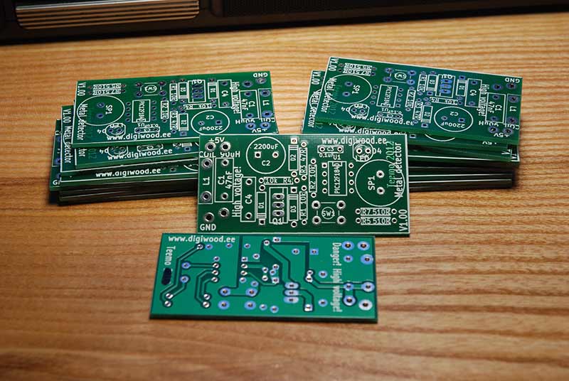

        • #64
          Hi
          No replays, and no feedback to the computer connection topic. I guess it got too messy. Nobody wants to hook up so many wires.
          So now I release new version firmware (1.26). This makes the circuit adapting even better to various coils and mosfets. Now it has automatic adjustment of the comparator reference voltage. When connecting power supply the PIC automatically adjusts the voltage treshold level for comparator.
          I add new firmware as attachment to here also.
          And picture of PCBs on my table:
          Best regards.
