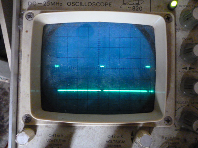

        Hi Teemo
        I had a bit of success and good start to your project
        output from pin 2, programmed with Pickit3 and MPLAB IDE 8.76

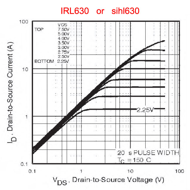

          • #80
            IRL630
            L = Logic level gate voltages. With "IRL" MOSFETs you can drive it straight from the microprocessor.
            For other MOSFETs you will need to add to schematic MOSFET driver IC or transistor (transistors).
            • #81
              As you can see IRL630 can drive several Amperes (ID) with less then 5 Volts on gate (Vgs). It is not so easy to find a replacement.
              • #82
                For IRL630 replacements the priority parameters are:
                -Gate treshold voltage(Vgs): must be less than 4,5V (often called "logic level mosfet")
                -Drain source voltage Vds: must be 200V

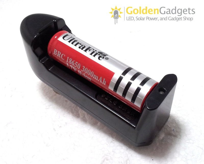

                    • #85
                      now i search for the smallest 5V power source so that all fits an a small tube enclosure
                      I am not sure will it work from 3.7V (charged 4.2V) 18650 Li-Ion battery. If yes it will be absolutely great because it is compact, rechargeable, lightweight and very powerful 3000-4000 mA/h! Click image for larger version
Name:	3.7V battery 18650 and charger.jpg
                      I am using 3 cells starting at full charge 4.2 Volts (12.6 V) and discharging to 3.9 Volts (11.7 V) after 10 hours of work of my overclocked to 130 mA Surf PI.
                      At least microprocessor will work.
                      Operating Voltage Range:
                      - 2.3V-5.5V (PIC12F1840)
                      - 1.8V-3.6V (PIC12LF1840)
                      The problem is IRL640 will work from 4 volts or not also maybe some adjustments are required to software and / or electronic.
                      • #86
                        i think about 18650 bacause i had a lot of them
                        but the have a critical voltage max 4.2 is not enough
                        so my favourite is a small akku pack of 4*1,2V aaa nimh (eneloop?)
                        and a simple charger plug with max charge of 5V usb or micro usb??? - modern standard
                        what do you think?
