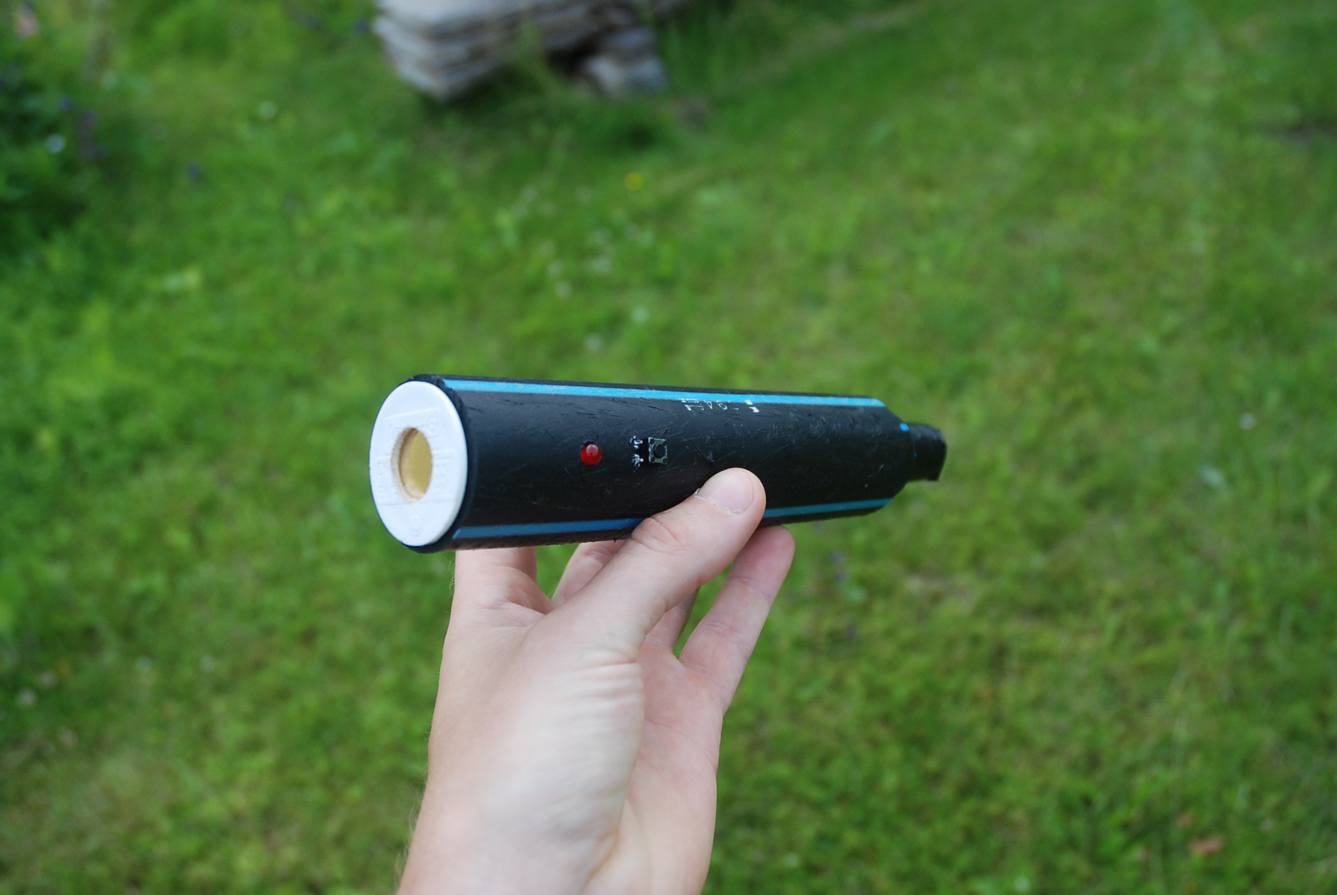

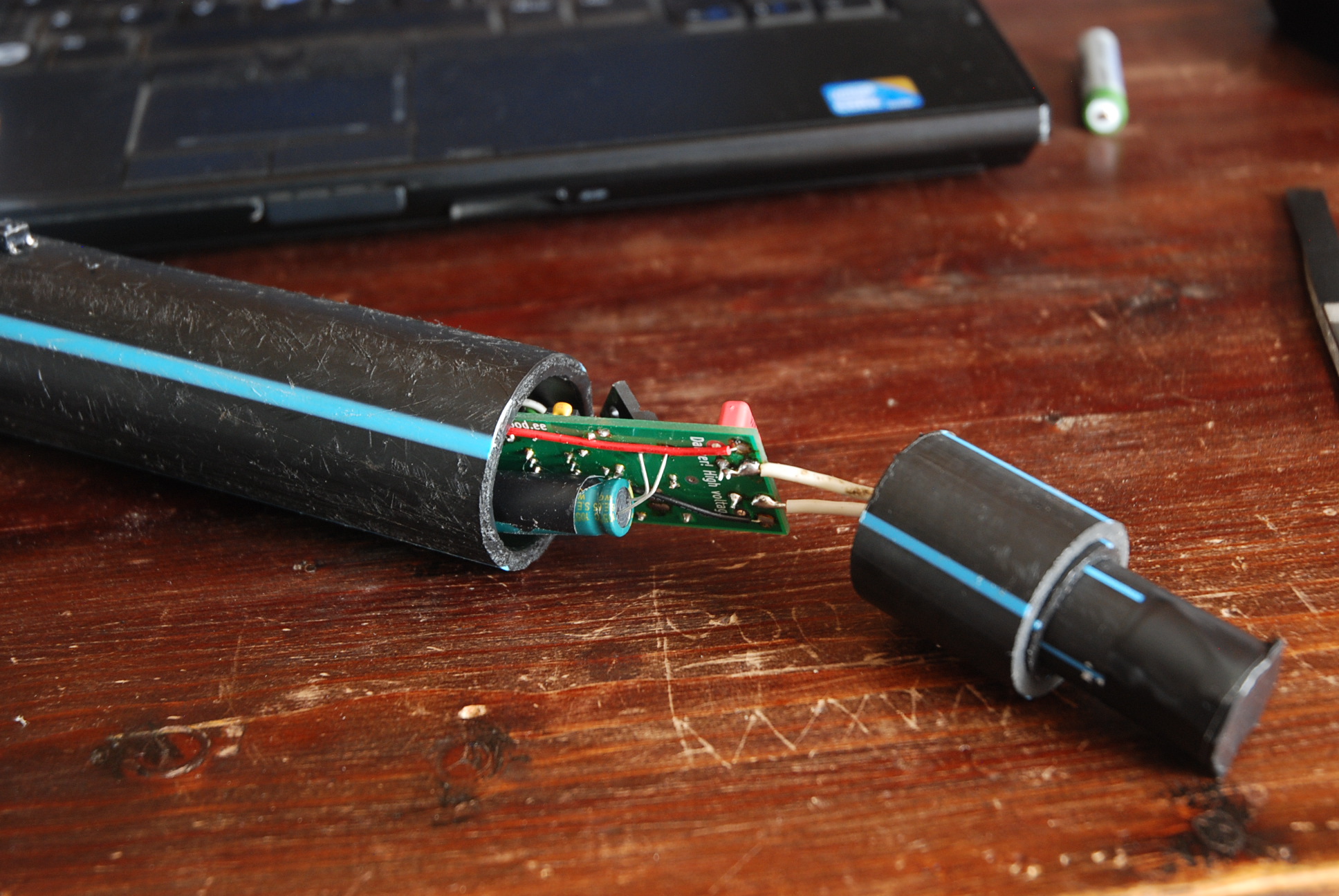

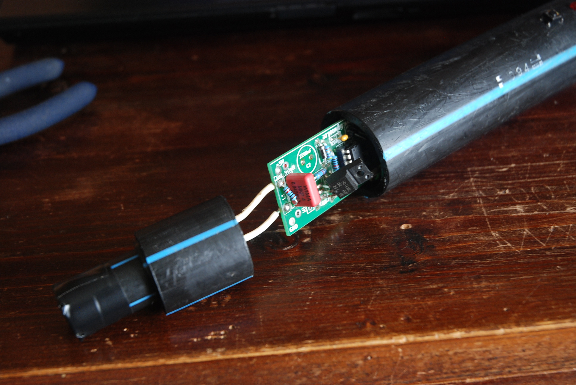

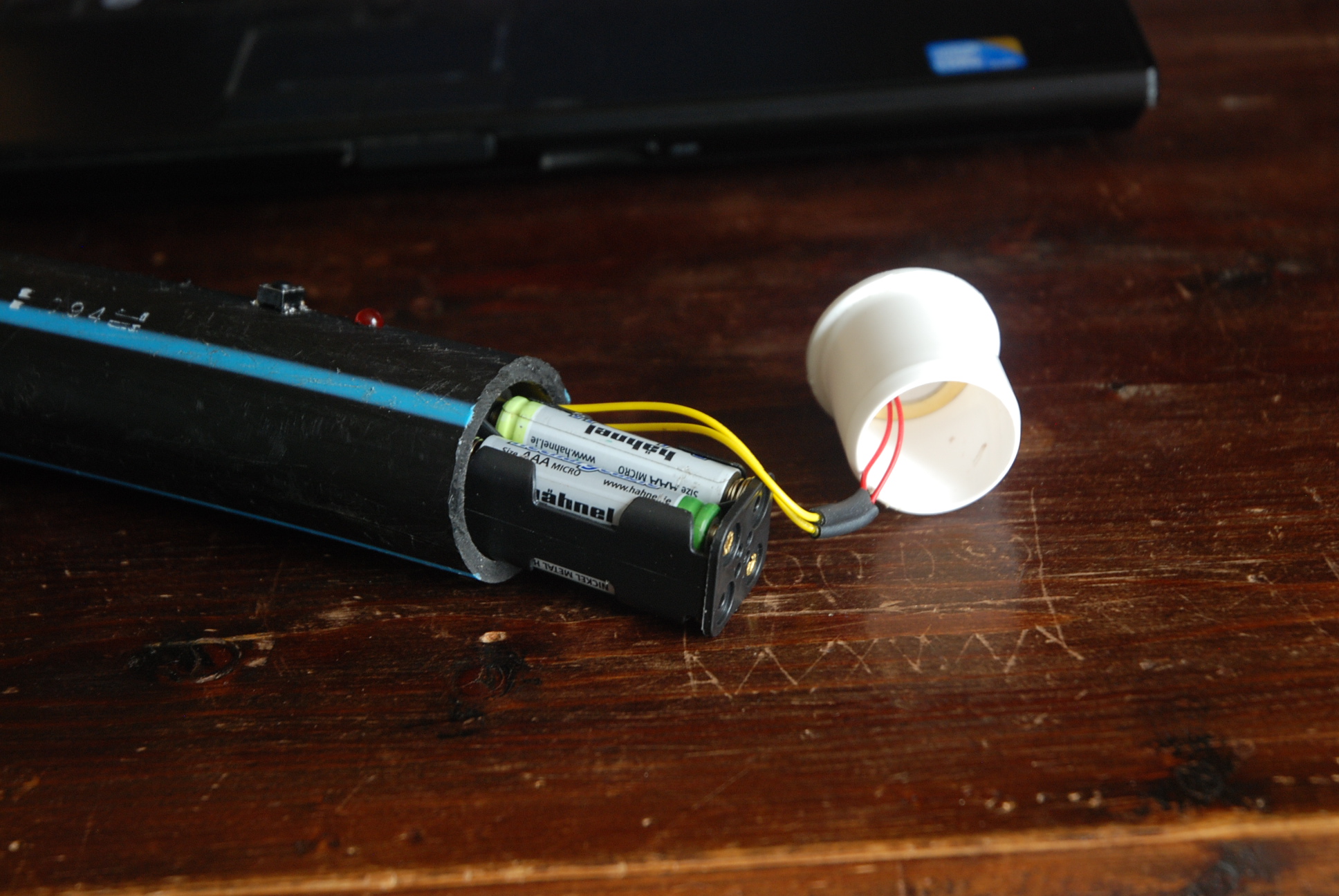

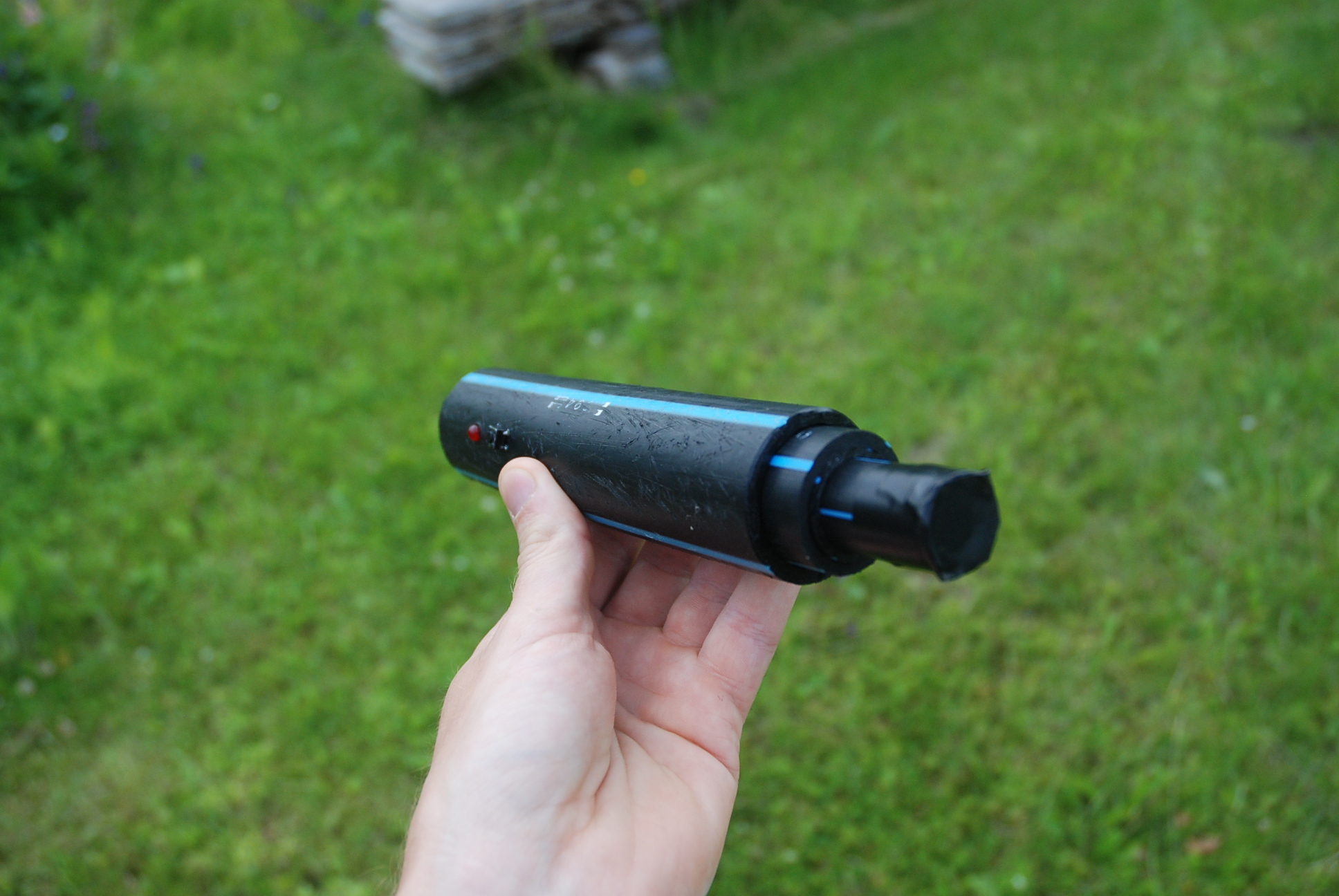

              Pinpointer pictures
              Hello everybody!
              I'll post some pictures of my pinpointer. (Got the inspiration to make one from the video Juha made about making pinpointer with my circuit:
              https://www.youtube.com/watch?v=nS4GWuD5Dk8. I did not have exact same tubes so I used what I found laying around and came up with little different.
              Fortunately I found plastic water tubes of 4 sizes that fit perfectly tight inside one another and a plug to close the other end.
              The 4xAAA battery holder and the circuit board fits nicely inside the tube. Only had to mount the C2 electrolytic capasitor to the other side of the PCB, and bend the leads of the MOSFET a little. Used coil with ferrite core. Speaker is piezo glued inside the cap with hot glue.
              Basically quite durable and easy to make waterproof, only the button is weak spot at the moment. Also I have not closed the coil end with the heatshrink jet, to make it easier to experiment with the coil.
              So here are the pictures. Hope you like it.
