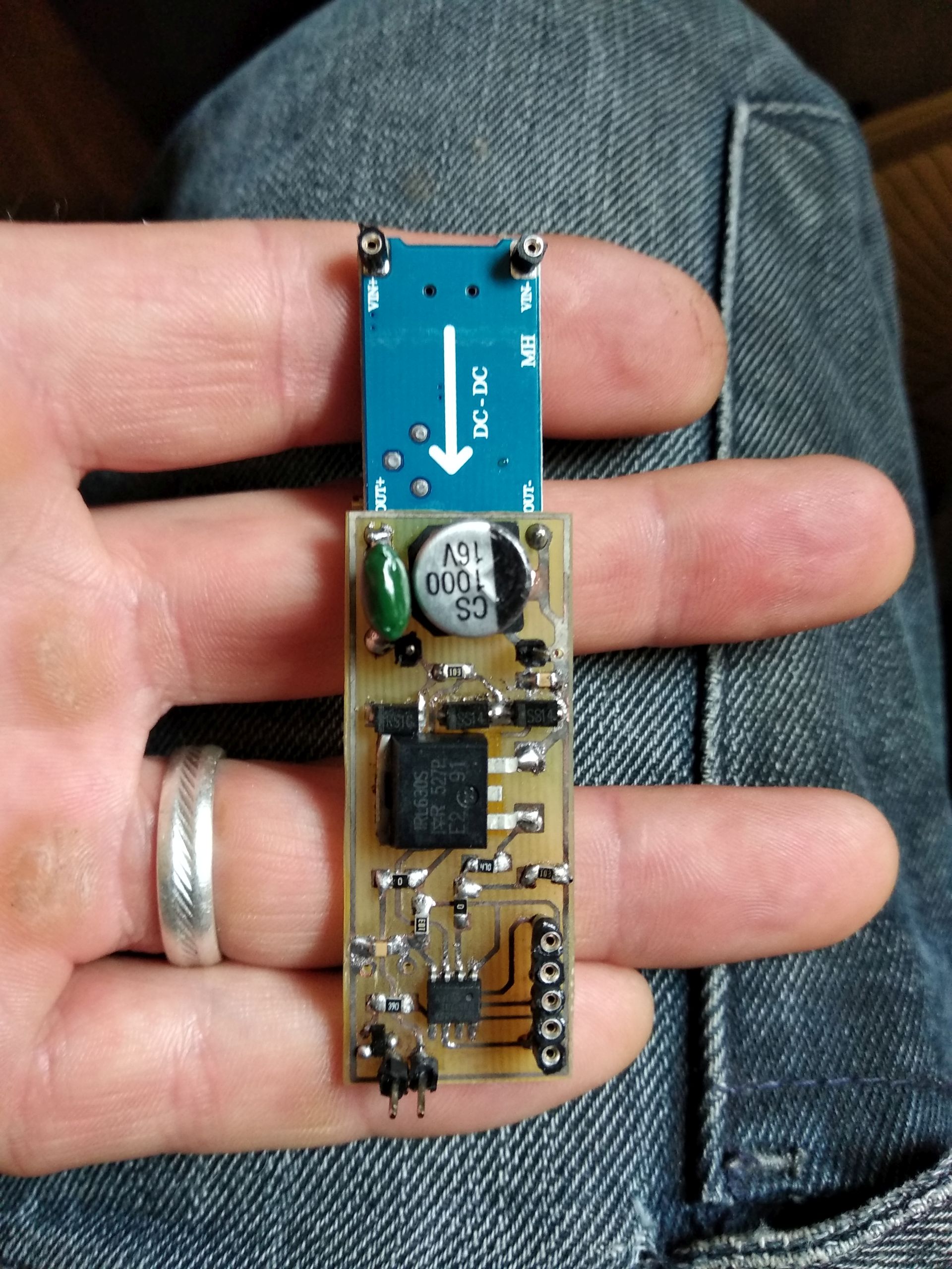

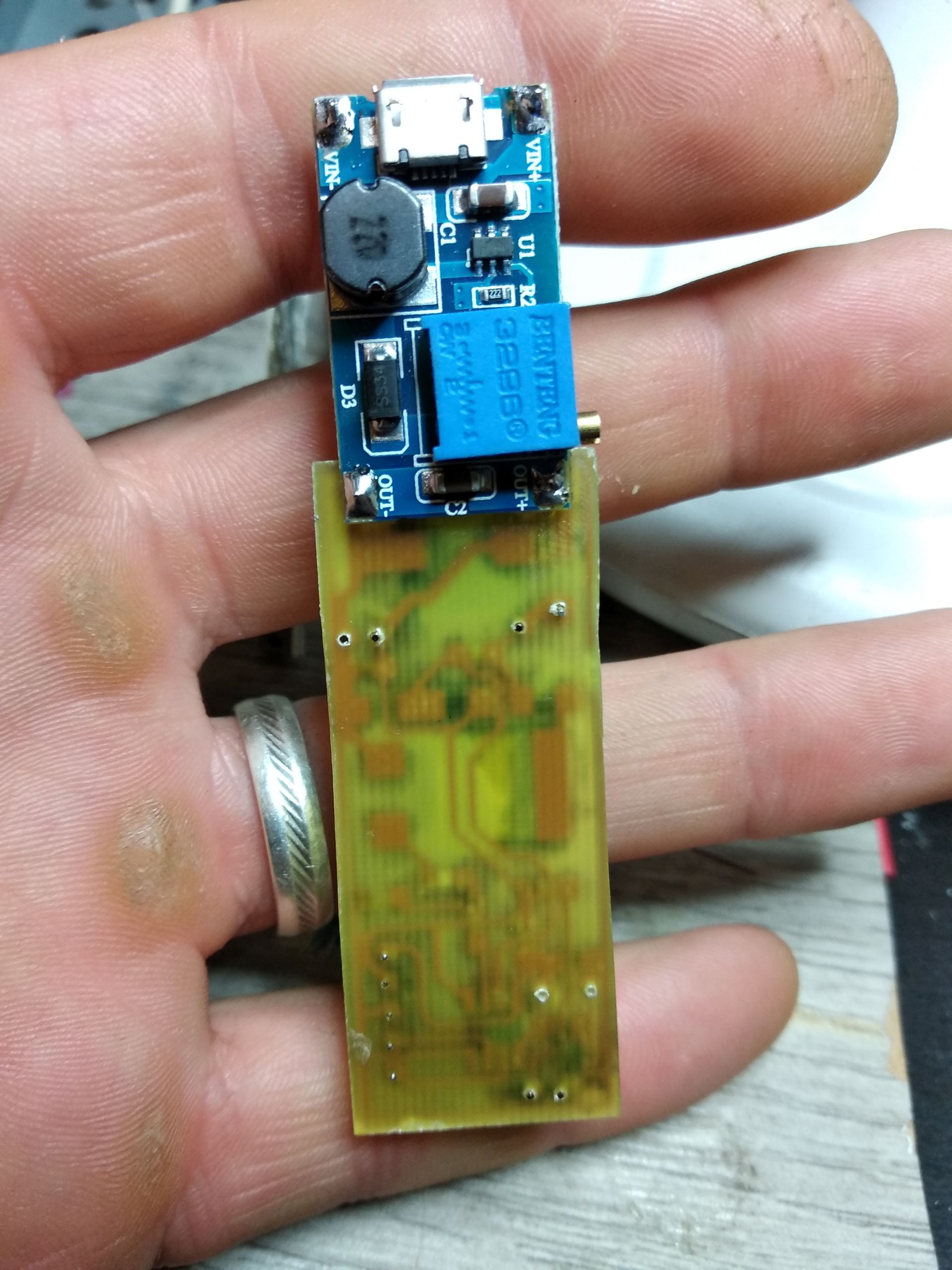

            • Hi,
              Firstly, thanks Teemo for his great work and sharing files.
              I've just finished two boards. If someone is interrested into building SMD version (only 5.5cm X 2cm... and could be much less!! ), i share my work here.
              I've added a BC848 transistor to get more power on the piezzo and i've taken off the diode which i don't know the use.
              I power it with a single 3.7v battery with a dc to dc board (it can give more than 16v with 3.7v in and cost 1€ on ebay), see pictures.

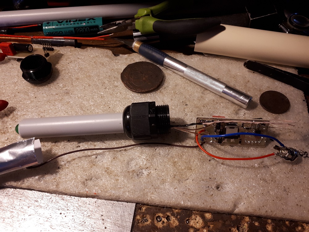

                  • Good evening! I assembled a ferrite head-470mkGn, length 100mm, made a chic case and what to say, I hastened to leave feedback, yes, I saw gold, yes, good range, but when I picked it up and waved it in the air, that's all the problems, constant workings. On the author’s board from the kit that he sells, you can see the third conclusion “-”, tried to shield the sensor, there is a constant, uninterrupted sound. Maybe he threw off such firmware ..., after all, for him it’s a commerce, but for himself he came to the conclusion that he is not suitable as an IDU with such work. Unfortunately, another disappointment uring ...Click image for larger version

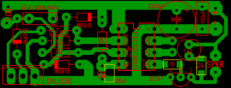

                        • hi nikko
                          can you put lay file into zip or rar container as attachement? thx
                          • Originally posted by nikko10 View Post
                            [ATTACH]47030[/ATTACH]now the LED is triggered along with the booster
                            This PCB layout is MISSING the PIC's ICSP header!
                            This leaves no way to connect a PICKit programmer to Flash the code.
                            • The microcircuit can be programmed through an adapter, it is not necessary that the pin pins on the board, only take up space. I don?t know how to insert the archive in the RAR message, here is the link of the Russian-language site where I posted this archive.
