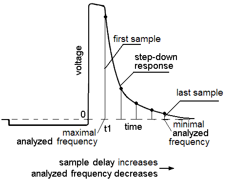

                    Moodz, my question is not for sample rate, but for number of samples in a period of TX current. I will try to explain the question with a drawing showing the received signal of PI machine as step-down response in time domain. We need information for responses at a number of frequencies (for example 17 or 28, below are shown 5).
                    Let assume I wish a PI metal detector to collect data for calculation response of a single frequency (operation as VLF) machine. My RX should calculate target response at frequency f1. I take a sample of step-down response at delay t1. This corresponds to maximal operating frequency f1 in frequency domain. When I increase delay, the frequency f1 decreases. However this is not enough for calculation of single frequency response. Stability of calculation needs additional samples for reference. That means, when I wish to use a PI detector as single frequency mashine, I should take minimum two samples to calculate stabile results.
                    When I wish my PI to operate as a sine induction mashine with 5 frequencies, no need of additional samples because one sample is reference for the other and the calculation will be stabile.
