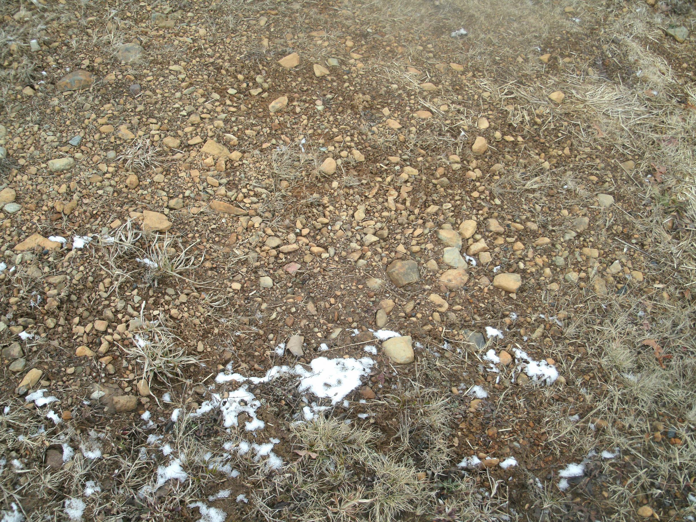

                      Bad Lands Picture
                      Here is a picture of a small area in my bad lands coal waste.
                      Most of these small items attract easily to a magnet.
                      Very little grass grows in these areas.
                      Impossible to detect past 4 inches in depth.
                      I've actually buried coins at 4" and the detector would not sound off when passing the coil over the buried coin.
