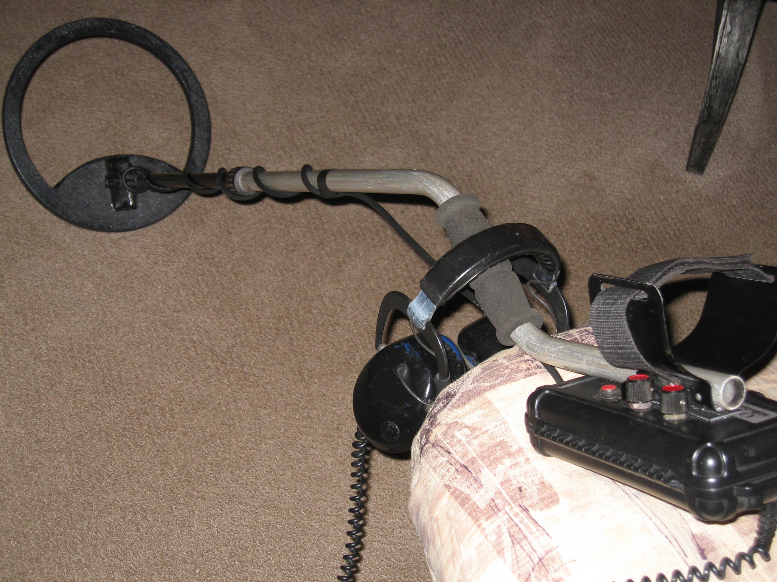

    I know what you mean about the baracuda. Mine is a keeper for sure. In fact I just built a second one. I have not had mine out since last summer at the beach but I was digging things amazingly deep in the surf.
    I'm using all the parts supplied by silverdog for both but I did find a difference between my first and second build. I cannot get my second one to react to ferrous the same way that my first one does, although I have not used the same coil on both yet. I'm using a 9" coil of about 450uH on my first build. Unfortunately, I'm stuck to coils no larger than 10" since I cannot vacuum form anything larger from the kitchen oven.
    As far as the coil goes, right now that is my limiting factor for depth and I am getting maybe 10" on coins.
    Also, I'm very curious about the TIP127 as I am using the IRF9640 and what the differences actually are.

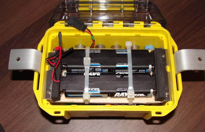

        Mine is unstable in the house has well. One observation I made while playing with the dampening resistor... It seems like the 450uH coil is overdamped somewhat with the 330 Ohm resistor, so I bumped it up a bit. The closer I got to critical dampening, the more noise. I got to almost 900 Ohms until I could detect any ringing. In the end, I just left the 330 Ohm resistor in place as it ran quieter with no loss of sensitivity. I will have to take a trip to the local Radio Scrap store and pick up a TIP127 as I think they carry them there. Did you use a heatsink with the TIP127?
          What Otter box are you using? Are you using it as a water machine submerged? Wouldn't mind finding a more compact waterproof box than what I am currently using by Underwater Kenetics.
          Good luck with your Cuda

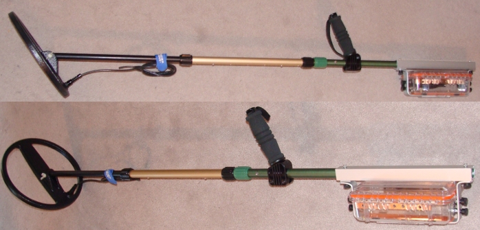

            Sven, I think you might have mentioned this before, but where do you order you parts from? (pole and handle). I want my next one to be a straight shaft arrangement.

              Don,
              That straight shaft was made up of multiple parts I had on hand from various detectors.
              At the time didn't feel like spending $$ for a commercially made straight shaft set-up

              Fisher lower rod and middle rod, Garrett Master Hunter middle rod. Minelab handle (was $24 now $30) from http://www.metaldetector.com/metal-d...poles-hardware
                Don yes I used a heat sink as that is what I received with the kit.

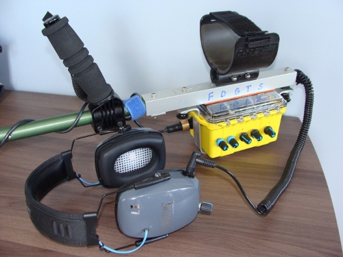

                  Hi Sven,
                  It's a Otterbox 3000 I believe. 8 x5 x2 inches roughly. I use a small battery pack made up of aaa nimh's. I don't think your setup would fit with those large batteries. There also isn't any room on the side for switches. My coil connection and headphones come in through the bottom also for the same reason. I don't submerge it but it gets a good dunking once in awhile. So far it has held up very well.
