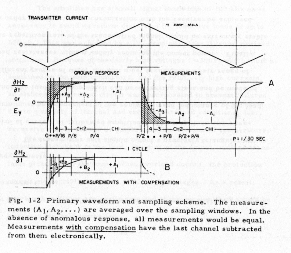

Triangular Wave Technology
  • Triangular Wave Technology
    Described in a 1975 thesis by Yves Lamontagne, Research in Applied Geophysics, University of Toronto.
    I'm sure I have seen a logo somewhere recently, made of similar shapes.
    Eric.
    OK, there is a triangular current flowing through the Tx coil, but in all honesty, the step voltage is the force that produces triangular currents and that also excites the response from ground and targets.

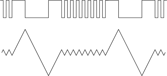

              Also the same method used in Minelab BBS/FBS. Flyback is intentionally suppressed so you are left with a more CW-type system. You can either demodulate in a traditional VLF-style CW demod (isn't that what CZ does Dave?) or in a time-domain-style demod like Minelab.
              BTW, here is the Minelab TX voltage and current waveforms:
                This current wave form is working very nice on my sound card platform as well. But the demodulation and GB is way way more elegant. And you don't need the FBS/BBS thing.
