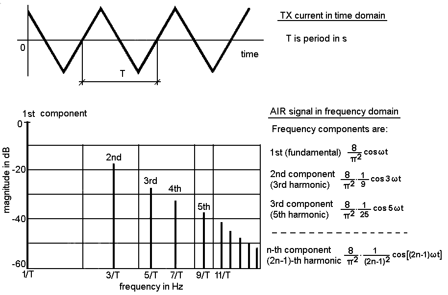

      You can vary the pulse width (PW) of the step voltage source (for instance coming from an H-bridge output). You get two different time constant current slopes (switch-on/switch-off). E voilĂ , you can do some kind of spectrum response equializing (rising the high frequency parts). As the coil current isn't symmetric anymore, you even get the even frequency harmonics (2*f0, 4*f0, etc.).
      This simple waveform gives you more target response for the long TC targets than a high end PI detector.
      Aziz
      PS: Try a PW of 0.3 or 0.8 and see the frequency spectrum.

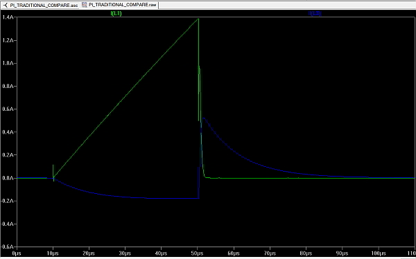

        Attached is a simulation of a 40us TX pulse and the response of a target of 10us. We can clearly see that the maximum "target saturation" has been reached long before the end of the TX On time.
        At switch OFF, the current in the TX coil reverses. The eddy currents in the target inverse too and reach a much higher amplitude because of the higher di/dt.
        The green trace is the TX pulse.
        The blue trace is the target response.
        The coil is critically damped.
        Any comments?
          High end relic and nugget PI's that are currently on the market would be more accurate. You can of course make a PI do what you want by changing the timing. Look at the geophysical PI's, many of which have TX pulses in the mS range and sample very late compared to the PI's we are involved in. I have a unit which is relatively poor on small coin size targets, but will be hard to beat on anything of golf ball size and upwards. Also there is another way of sampling which looks at the total field return from the target and this enhances long TC signals at the expense of the short.

              (1) PI
              field (Ф) – exponent (f(exp))
              a) magnetization: dФ/dt - exponent (f(exp))
              b) conductivity: ddФ/dt - exponent (f(exp))
              response from the targets = a+b
              (2) Triangular
              a) magnetization: dФ/dt - constant (f(const))
              b) conductivity: square wave electric field in the target - creates exponential signal targets
              (2) - has a lower sensitivity to the magnetization and high sensitivity to the conductivity (good for finding gold nuggets )
                Zilch target response or huge target response - that's the question.
                PI detectors are inherent optimized for small (and low conductivity) targets. Due to the fact, that TX coil = physical same RX coil, you have to damp all the coil energy very quickly to sample as early as possible (response signals die out quickly).
                You don't use the TX on-time response. (1/2 total response energy wasted)
                You don't use the TX off-time flyback period until the sampling begins. (big response energy wasted)
                You are just sampling a tiny fraction of the whole response signal. And you have to amplify the response signal many many times (amplifying EMI noise, amplifier noise *LOL*).
                If you do some sophisticated signal processing (using a DSP/µC) on the triangular/quasi-triangular continious wave current principle, you can get more target response than a PI could ever ever get.
                And this principle is prior art, easy, cheap, not critical, very power efficient , ... a proven good old technology.
                You really get more for your money or effort.

                    Are you guys interested in the frequency response of some triangular wave forms?
                    With varying pulsewidth too.
                    (I could quickly implement it and do a FFT)
                    Aziz
                      Go on, let's see what's on your mind
                      • #41
                        Any comments?
                        Tinkerer
                        That is exactly what I would expect to see. The total decay of the target trace post switchoff extends for about 50 uS, so as you say, it has a TC of 10uS. Looking at the negative decay it would likely extend for the same time, except that it is curtailed by the 40uS to switch off. However as the starting amplitude is lower, for the reason you give, it appears flatter. At 5 TC's though, there is only 1% of this smaller signal that subtracts from the switchoff decay, which is insignificant.
                        Eric.
                        • #42
                          http://www.wolframalpha.com/input/?i=fft%28trianglewave[x]%29
                          (fugg, link doesn't work. Just enter in the edit line: fft(trianglewave[x]) )
                          (requires more computation time)
                          Damn it, I have to code it by myself.
                          I'll look for online FFT calculators before I start the coding..
                          Aziz
                          Wait: Look here... (for m = 3, 4, 5)
                          http://mathworld.wolfram.com/Fourier...angleWave.html
                          Wow, avoided a lot of coding work now..
                          Aziz

                            • #44
                              Ok guys,
                              I have been told, that you all love math.
                              Check this zipped Excel sheet out. Just enter the PW field and see the spectrum distribution for up to n=8.
                              FFT-TriangleWave.zip
                              (I hope I didn't make a mistake.)
