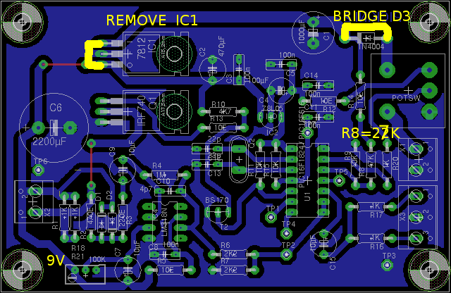

    is it possible to remove the 7812 voltage regulator from the pcb to drive the circiut direct from 12v accu
    is it possible to change some parts and the source code to support a 12v standart accu?
    i think biggest disadvantage is the uncommon voltage range whichi used
    or are there any parts which need a higher voltage then 12V?
    kind regards
    • You may try bridging the 12V stabilizer and removing D3 to power the circuit directly from a 12V accu.
      The low voltage detection is determined by the divider R8 / R9. R9 should increase then to avoid continous low voltage alarm.
      The DC adjustment for the opamp is also critical. This wil also drift as the power supply changes. But I am not an analog specialist, so I have no advice on how to overcome this ( a zener diode ?... )
      I haven't tried yet, but if you can come up with a simple solution, this would definitely be an improvement

        • PICKINI with unstabilized 12V power supply
          I did some more tests on how to change the power supply from a stabilized 12V that needs 15-18V input to a direct 12V power supply.
          This allows for a simpler and lighter battery pack.
          These changes on the PCB gave me a 9V - 14V DC input range:
          - remove the input diode D3 and replace by a wire bridge
          - remove the 12V stabilizer IC1 and connect pin 1 with pin 3 by a wire bridge
          - apply 12V DC at the power input terminal and adjust the multiturn R21 for 9V at the wiper
          - low voltage detection at 10V power supply: R8 = 27K instead of 47K. -- (instead of 22K on the PCB drawing)
          -Bernard

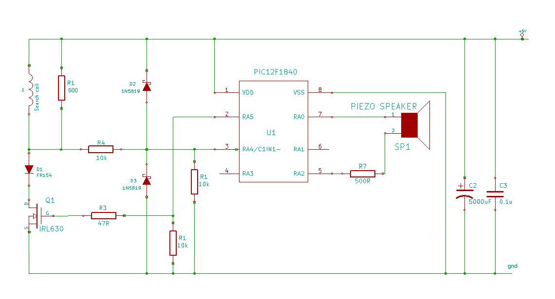

                  • Probably it is good idea to use IRL630
                    Coss 220 pf
                    Ron 0.40 ohm
                    Also IRL630 works from LOGIC LEVEL signals so you can remove T2 (BC170) if change software to invert PIC output.
                    Check out "Pulse Oscillation detector project" from Teemo for good front end idea. Just need to put dumping resistor instead of capacitor in parallel to coil and use resistors divider on PIC input to shift input voltage down.

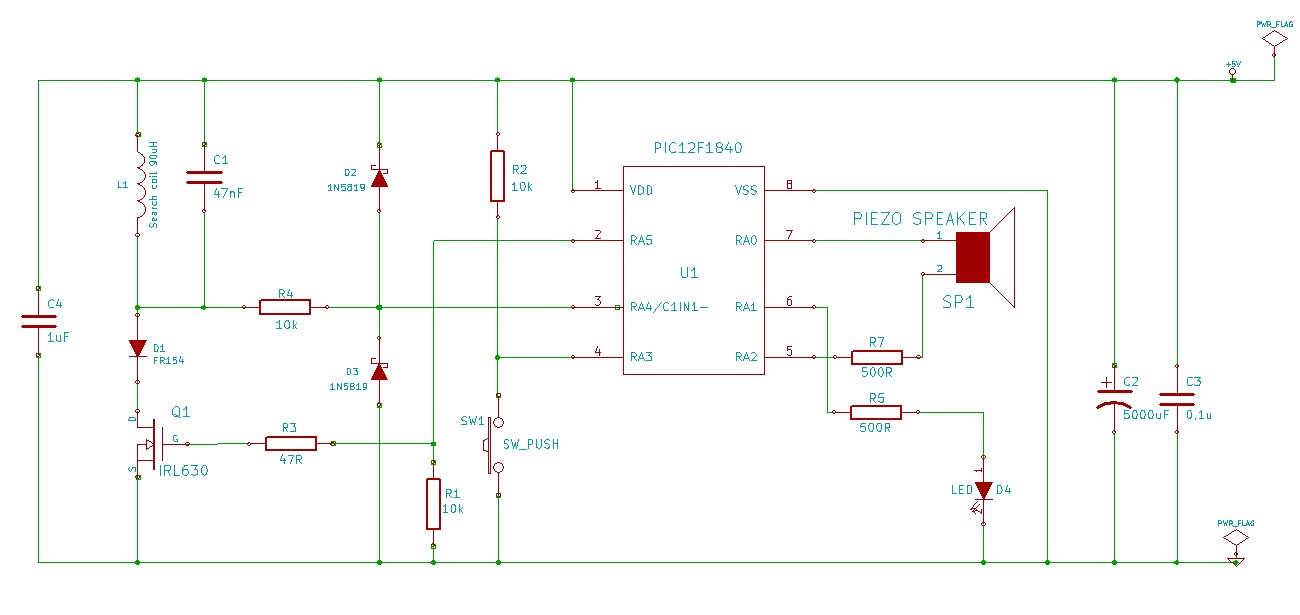

                    Something like that should be working but it needs proper changes to the software. Sure it will have less depth but for cheap detector with minimum parts or pinpointer is OK.

                    • Check out "Pulse Oscillation detector project" from Teemo for good front end idea. Just need to put dumping resistor instead of capacitor in parallel to coil and use resistors divider on PIC input to shift input voltage down.
                      I am familiar with this excellent project by Teemo.
                      Not sure if a direct flyback pulse feed - divided by a couple of resistors - will have enough resolution to detect any changes in pulse width.
                      Normally, a PI front end has a 1000x amplifier - on the bottom 0.6 V only (clipping diodes)...
                      To quote "Inside the Metal Detector" page 146:
                      The decay shift caused by targets will be in the microvolts to millivolts range. Keep in mind that this small perturbation is riding on top of a waveform that peaks at perhaps a few hundred volts.
                      In theory, this schematic should work.

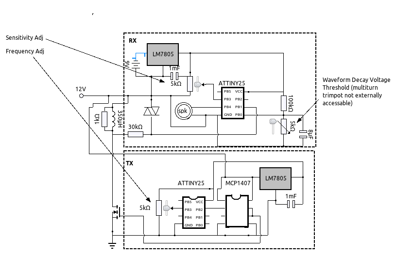

                      • Yes. You are right but it is always tempting to make stuff as simple as possible.
                        I have found earlier on this forum that PI detector without preamplifier has been build.
                        It is using ATTiny25 MC with similar principles (comparator + timer).
                        Also that is interesting even if ATTiny works on lower frequency micro-controllers timer/counter has been clocked at 64MHz to increase sensitivity.
                        http://www.geotech1.com/forums/showt...ighlight=TPIMD
                        I hope to see some day PI detector with few parts only.
