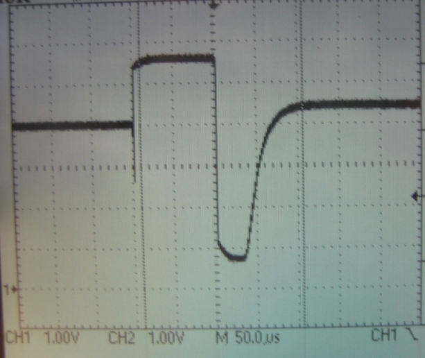

                              Please check that the signal at pins 8/9 of the microcontroller looks like this:
                              this is the end of the flyback decay (clipped to +/-0.6V and amplified 5000 times.
                              Pin 11 of the microcontroller should output a digital version of this pulse ( after the internal comparator).
                              At pin 13 you should have an adjustable DC between 0 and 5V (almost) with the potmeter.
                              Obviously, the PIC programming, timing etc is OK since you have the welcome sound and the ticks.
                              • #60
                                Both of them act the same way. Scope not working. Pin 13 is doing 0 to 5 with the pot. All the solder joints look good under a magnifier light. Went over most of them anyway. Mike in MN
