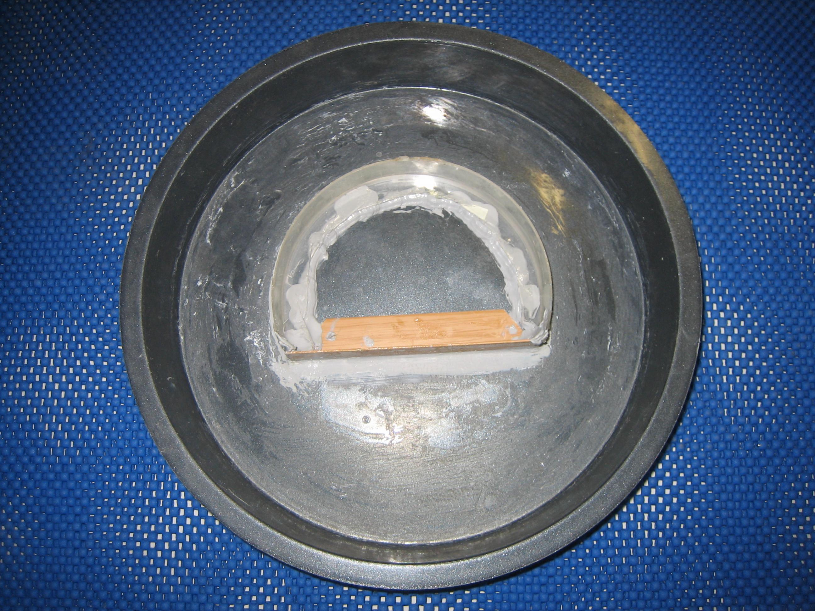

      • #78
        F117
        in post #75 how are you making the coil former/shell for the flat coil ?
        thanks
        • #79
          F117
          thanks
          I use a round silicone baking mould - for baking cakes - costs around 10€.
          Inside I glued the inner "hole" for the fixation brackets and cable connection. This piece of circular scrap plastic (don't remember where it came from) was siliconed to the mould.
          Before pouring in the 2-component resin, I have to rub some Vaseline to the inner plastic. The rest of the silicone mould doesn't need this, the resin does not stick to it.

          • #80
            Hi Bernard
            thats a very clever idea using the mould
            thanks for sharing, this gives me a few new ideas to try, thanks.

              • #82
                Hallo Bernard
                Wich brand and type of resin did you use?
                Leendert
                • #83
                  Leendert
                  Hi Leendert,
                  I used Blitshars F31 A+B from Vosschemie - here in Belgium, there is a shop in Brugge.
                  http://fvh.ccatnet.be/hobbysite/blitsharsen.htm
                  It should also be available in the Netherlands:
                  http://www.vosschemie-benelux.com/
                  Best regards,
                  - Bernard
