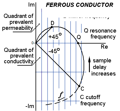

All depends on sample delay or frequency
"Skin effect" is a term of frequency domain. When you use it, you should point at what point of frequency spectrum it dominates. The same is valid for time domain: At what sample delay magnetization of the iron core prevails?

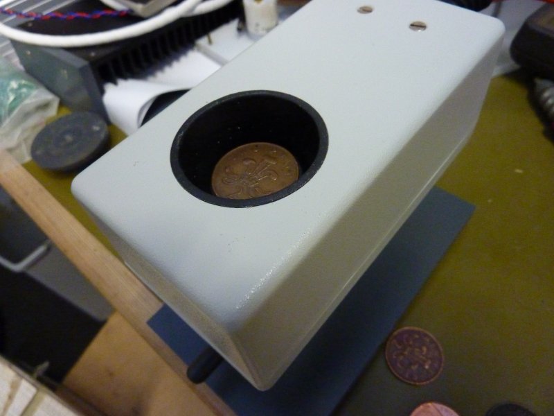

In frequency domain all is clear. When we have combination of conductivity and permeability, there is a resonance frequency (point Q) at which X=0. If you have coins 1, 2 or 5 Eurocents, you can measure the resonance frequency.
