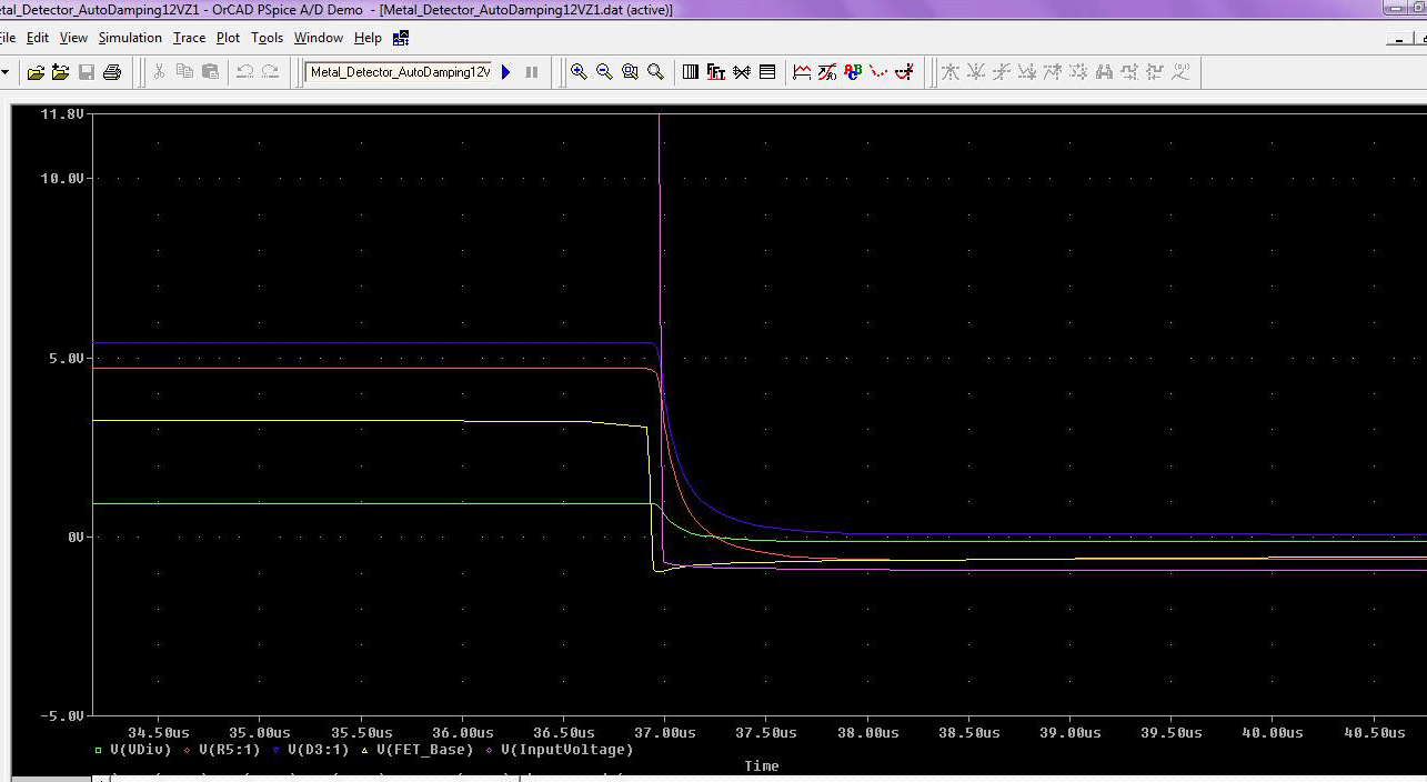

        We really need to see the screen shots. There must be no ringing at all. 12 to 15us is long.
                Tinkerer, please allow for youthful exuberance here. I really am dysmathic, and this is my first attempt at a major modification of someone else's modern, properly designed PI front-end. I'm lucky the damned thing didn't catch fire, fall down, and sink into the swamp!
                But I appreciate the feedback... Now that I know this is a good starting point, I can begin to tune my little circuit to improve it, step by step.
                At least it seems I'm in the right ballpark. Thanks for the information!

                  A little proof...
                  OK. I have good news, and I have bad news. The bad news is that I've fried my Due module, and they're going to be on backorder for 3-4 weeks.
                  The good news is, I've managed to grab a spice simulation shot for the falling edge of the inductor's pulse. Please note, I was out by an order of magnitude of my estimate of the damping time. My apologies for that, I'm still getting to grips with PSpice!
                  Now, I apologise for everyone with modem connections, but I can't seem to use one inline image (I prepared a thumbnail to help those people) AND just have another larger image as an attachment.
                  At the moment I'm snookered re: getting an MCU I can easily program and use as a simple pulse generator to drive my TX butterfly coil with variable pulse widths, frequencies, etc. I have a box of old demo boards from Microchip and others, but they're all a bit old, and very difficult for me to program. But I think I've got an ARM Cortex M7 lying around somewhere. I'll try this afternoon to not blow that up too. Fingers crossed, I'll have some real information up in the next day or so.
                  So, here is the theoretical proof of your aliens, Orbit!
                  -PtB
                  [EDIT] : Sorry, forgot the legend.
                  The purple trace is the coil + voltage.
                  The red and blue traces are the ones I'm interested in, they are the front-end amp's - and + inputs (I think! This version of spice is very unfriendly in terms of naming and identifying signal traces),
                  The yellow trace is the derived signal for controlling the damping.
                  The green trace is just a bias signal between ground and the + input of the op amp.
                  Note that I don't have an op-amp device in the circuit, as none of the models remotely reflects any of the devices I'm evaluating! I might actually build an equivalent differential input circuit from discretes and try that. But later...

                  Yes, I realise I have much to do. I know I need to reference one end of the differential (diode-clipped) inputs. As I keep saying, I'm a self-taught electronicist with bugger-all maths skills, so every circuit I build, I learn something new. That's why I build them! Having said that... any obvious things I'm overlooking? Comments are most welcome, I need to learn so much. And - thanks for looking. I feel totally embarrassed about submitting even this to you guys! So please be gentle with me.
