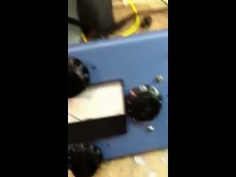

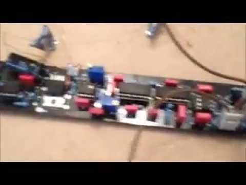

              Here is another Surf Pi, Silverdog version. See video link. I'm getting some noise that I cannot seem to get rid of. I have made a couple different coils, the last one a shielded type. Range is not what it should be I don't believe. I cannot completely quiet the audio. Looking at the garbage on the scope...its what I would expect. Functionally, the MD works. The offset pot adjusts correctly. The delay pot (I brought that out to the control panel) works as expected. I added a number of ferrite beads on the wiring around the board, except the pots. The case is aluminum.
              It could be just noise pick-up by the search coil, which is a bunched coil type, about 350 uH. I wish to try another shielded coil using copper tape, but I don't have any at the moment.
              Anyway, I would like some ideas from anyone who is pretty familiar with the design.

                  PIs are notoriously noisy when tested indoors, and the instability on your audio output sounds quite normal. If you re-orient the coil, you should notice the instability will change, indicating that this is external interference. When you use it outside you will see a big difference.
                    TNX. The location is my radio shop in the basement...so...did expect some noise as it is a PI. When the snow melts I'll try it outside. Just got 3 ft of snow yesterday....so it'll be a while.
                    My first MD and its been fun. I made a crude shielded coil but will attempt a better model. But I think the noise is EM and not E field. Kind of curious what the noise is. I did notice the changes with re-orienting the coil as you noted. I ruled out common mode noise being picked up by the coax (RG8X). But I am a novice in respect to MDs. Have really enjoyed the forum and site. I bought this Surf Pi a couple years ago and finally had a chance to put it together.

                          Yea, that's pretty typical of indoor testing. Just to prove that your noise is being picked up by the coil, wind a test coil and bend it into a figure "8". Almost all your noise should disappear.

                            Yep....had some other projects in front of it and friends kept bringing me radios to work on.....actually power line noise is quite good here. I operate AM (ancient modulation) on HF on several freqs with the ham stations and have no issues with power line noise. Great on your noise-free location. I'm still not 100% sure my noise is not my fault!!!
                            Don....that is a good idea. I ran the output into a resistor actually....no noise. I did try shutting off most of the AC near the bench. I noted the florescent lighting contributed to it (shocking discovery ). The noise is rather random, unstable and at low frequencies. The amplitude is of a spike nature (short durations). I'm more curious than troubled by it. Don't plan to search for treasure in my basement however. One way to possibly limit the noise - if its not a layout issue - would be to filter the audio and convert to a DC level. Then use a VCO to control the audio like a 555 I have seen in some MDs. Kind of a limiter using longer time constants. May or may not work.
                            So maybe the PI will be good noise detector? More work to do....and the snow needs to go away.
                            TNX for the comments.
                            Peter
                              Noise is a frustrating problem when working on some of these projects. If you read some of the TGSL threads, Simon Baker actually went on a Quest to find a location to verify a theory on detector performance and noise. With the TGSL project noise can manifest itself by lack of detecton range. It was not until he took a drive deep into the countryside until he was able to prove it to himself..
