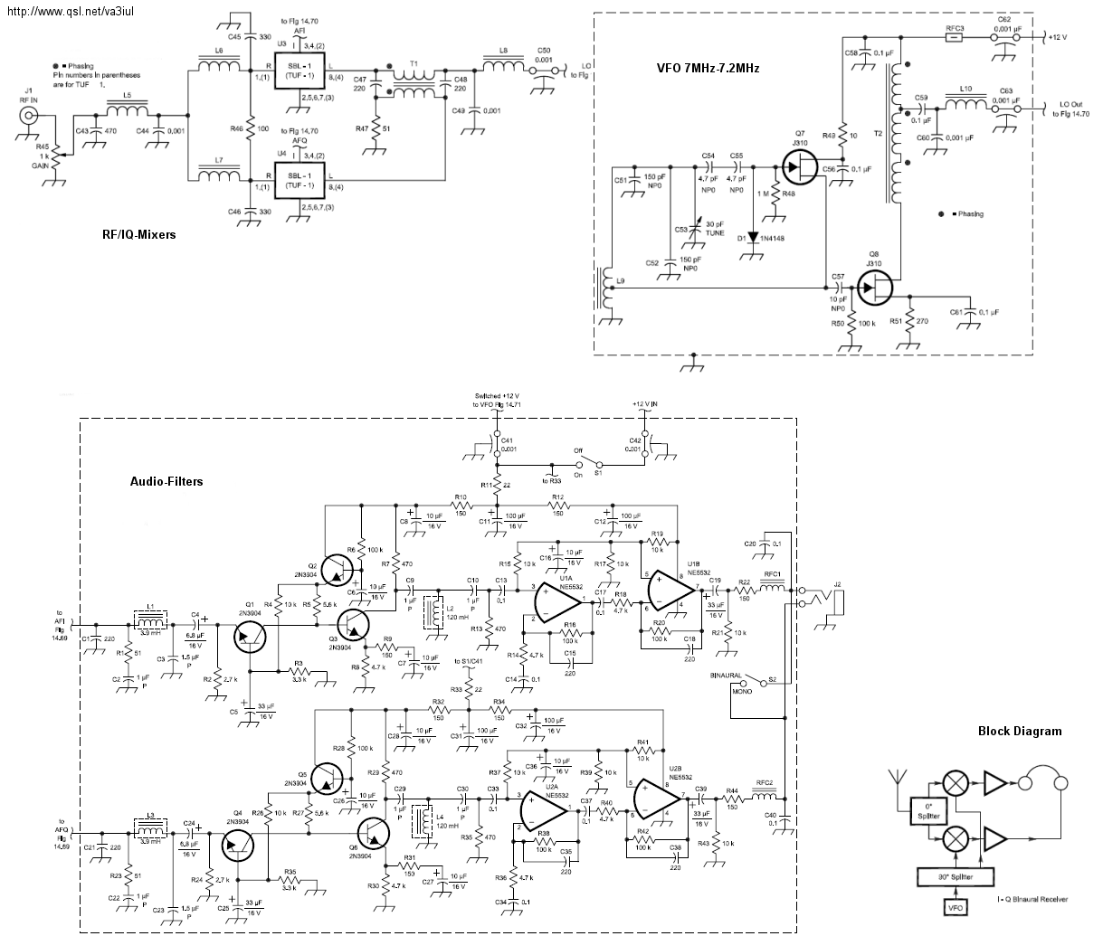

              Here is something else, I would like to know what Mikebg thinks of this altered for a lower freq.
                Here is a link if you need explanation how this design operates:
                http://www.kangaus.com/Documentation.../BIQR/biqr.pdf

                I think this method will operate better in VLF instead in LF radio band.
                  IMHO allpass networks are far better choice for creation of virtual sound space. Point is that 90° difference is just about right for frequencies around 1kHz and the distance between ears. Perfect binaural sound recording would require a dummy head. In lieu of a dummy head and perfectly aware that the same effect is obtainable by all pass delay networks, we can successfully play with binaural even without I and Q channels. Especially because we know exactly what the sound sources we have. Besides, it all makes sense only in a case where two (or more) independent sources need to be placed in virtual sound space.

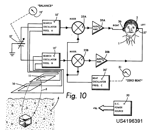

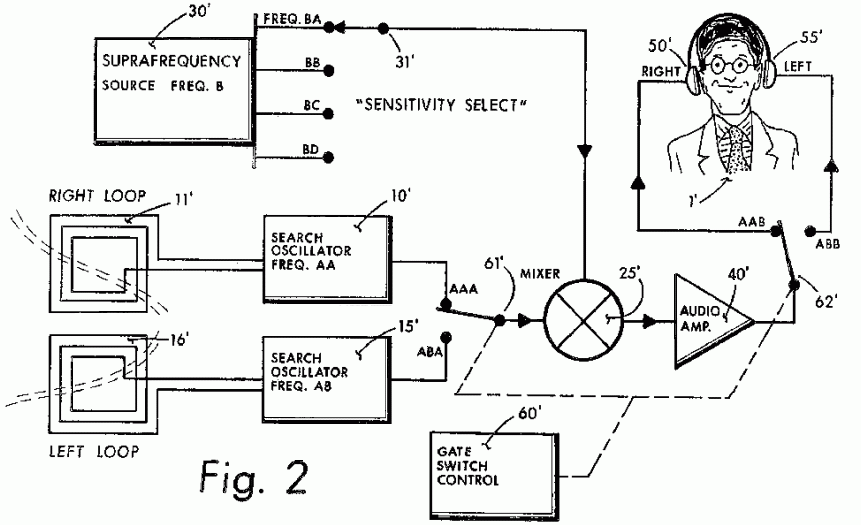

                        PATENTS
                        There are several software packages/apps that allow you to play with this effect - just look for effects for music/guitar/recording software. What if you take this stereo thing all the way - work with some sort of dual RX coil that we haven't tried before...
                        There are several patents with twin loops. I will try to find them. Here are two:
