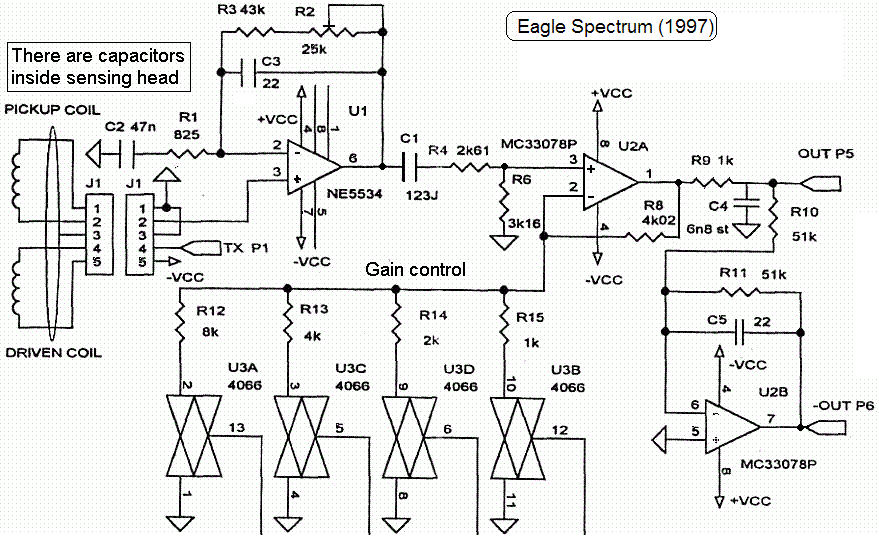

            Often preamps have a gain in the range of 10 and 20dB.
            S, gain 10 to 20dB of preamp is too small value. Note what gain has this preamp:
                Depends on the design. My current design has a 2-stage preamp, each 20dB. Any more than that screws things up.

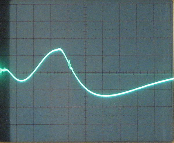

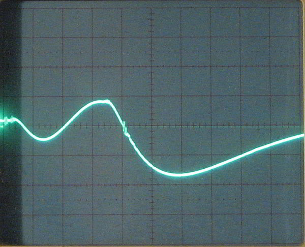

                    Maybe this helps:
                    I was just balancing a coil and have the signal available at the output of the preamp.
                    With a gain of about 10, the signal of a silver dollar at the center of the coil is about 1.2V.
                    This means the actual signal is about 120mV
                    The coil is about 260mm outer diameter.
                    I add the pictures below:
                    First picture: output of the preamp, no target.
                    Second picture: output of the preamp, with a silver dollar at the center of the coil.
                    Look at the changes produced in the signal shape, by the target.
                    Enjoy
                    Tinkerer
                      (With a gain of about 10, the signal of a silver dollar at the center of the coil is about 1.2 volts.)
                      When I look at the two traces I see about a half division offset. Is this what you are calling 1.2 volts? What would the voltage be if the silver dollar was at the diameter of the coil 260mm?

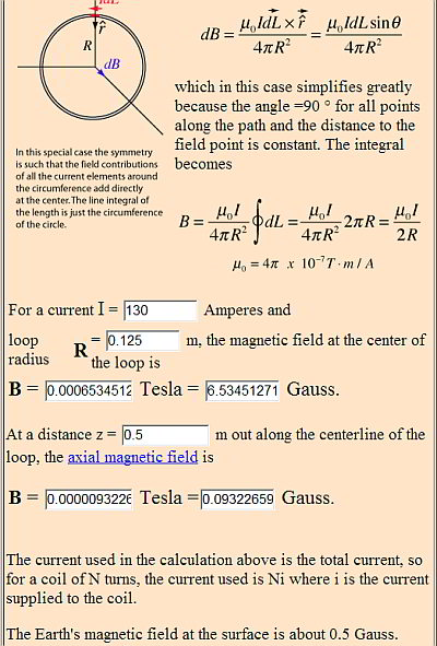

                          I can not show you on the scope, directly. The signal undergoes some processing, sampling etc. after the preamp, so there is no more direct proportion. But we can get an approximation by calculating the coil field strength.
                          I attach the field calculator link and a screenshot of the coil numbers.
                          I took the medium diameter of the coil at radius 12.5cm and then the distance of the diameter of the coil, x 2, because the signal emitted from the silver dollar target will have to travel that same distance to the RX coil.
                          The coil, when taking the reading of about 1.2V, as running at 5A peak TX current.
                          The coil has 26 turns, therefore we input 5x26=130A.
                          The coil field strength at the coil center is 6.534G
                          At a distance of 50cm, the coil field strength is 0.093, or about 70 times less.
                          Therefore, the signal amplitude from the silver dollar at a distance of 25cm from the coil will be about 120mV/70=1.7mV
                          Magnetic Field of a Current Loop
                            . Would the signal amplitude from the silver dollar in the center of the above coil be similar to a worse case ground signal, lot less, or a lot more?
