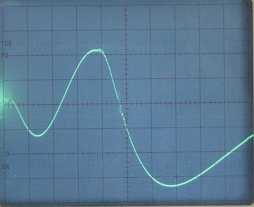

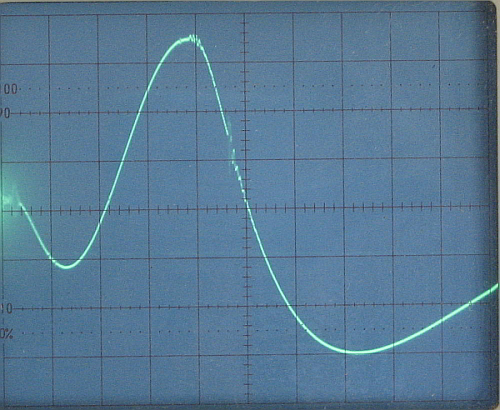

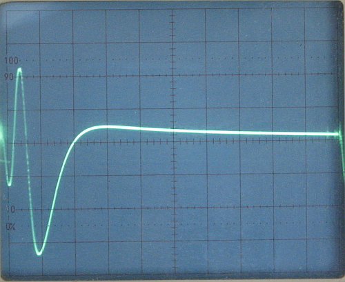

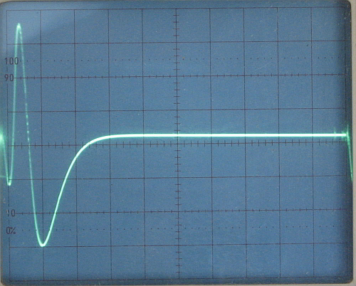

                          With a gain of only 10, the bricks alone could not be seen, while keeping a full wave form on the screen. Therefore I added an antique 6 pound cast iron cannon ball to simulate a very hot ground.
                          I set the distance of the ground target to be such as to give a somewhat similar target response amplitude as the silver dollar at the center of the coil, that is, close to saturation of the pre-amp, to represent the maximum dynamic range.
                          The vertical setting is 1V/div.
                          The horizontal setting is not calibrated, but the full cycle is about 100us, for 10,000 pulses per second.
                          Here are some screen shots:
                          NO ground_1, transient only
                          NO ground_2, full cycle
                          With ground_1 transient only
                          With ground_2 full cycle

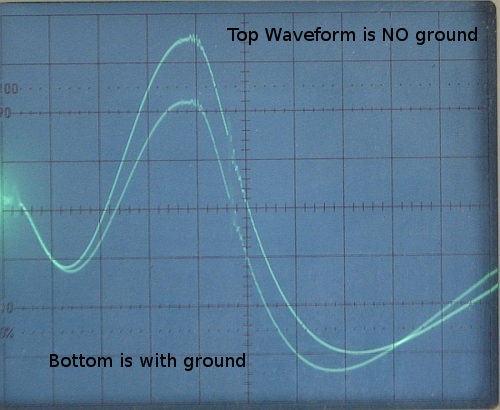

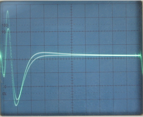

                            Hi Tinkerer, here you go.
Name:	Pix 2 combined.jpg
ID:	335174Click image for larger version
Name:	Pix 1 combined.jpg
                              Thank you mickstv.
                              So what do we see here?
                              1) We see the dynamic range near maximum. With +/-5V supply, the pre-amp saturates at about 4V. If we were to use +/-12V, we could increase the gain considerably. No need to increase the dynamic range, this is already extreme.
                              2) We see 2 spots along the cycle time, where there is no signal change. If we sample at the place where the traces crosses over, or at the end of TX, the changes are minimal.
                              We can also look at the crossover as the pivot. If we sample before the crossover, the signal change is negative relative to the NO ground signal, after the crossover, it is positive.
                              3) The biggest change in the signal is at the first positive swing of the signal, at about 6us. If we sample there, taking a 5us sample window, we get the highest amplitude.
                              Now, please suggestions for more tests.
                              I could think of adding a strong ceramic magnet to the cannon ball. This should increase the reactive response, without increasing the resistive response.
                              We could also try to add a short TC resistive target. I can see some change with a 1" square alu foil, that has a TC of about 10us, however, at the gain of 10, the change is very little and probably difficult to see on the picture.
                              Suggestions???????????
