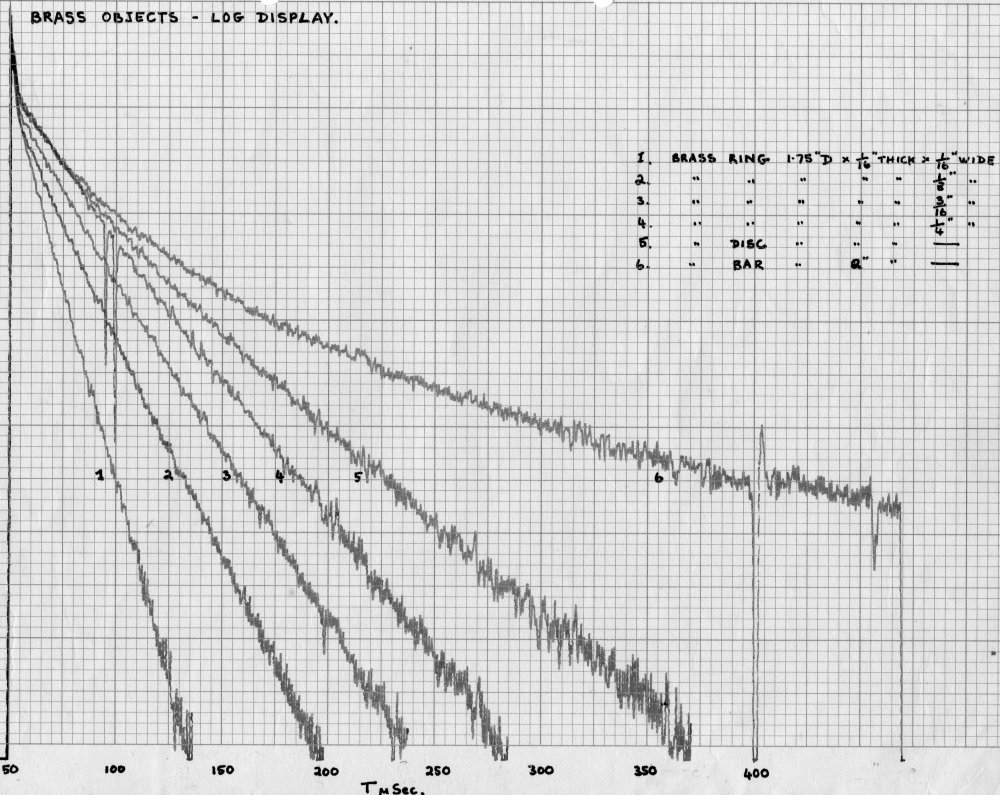

    • This is what a log display should look like. Taken by Tektronix scope with a plug in waveform scanner outputed to XY plotter. Tube technology too - not bad. Log amp was by Optical Electronics and was 8 pin DIL - also not bad for 1968.
      You can see that the rings 1 - 4 only differ in lateral width and display a single time constant. 5 is a disc and 6 is a 2in thick piece of bar. 5 shows a bit of curvature at early time and 6 curvature to around 400uS indicating a long TC that has not reached its fundamental TC until that time. The big spike at 400uS is an artifact and other spikes are noise.
      I have a plot for different coins which shows nicely how each coin can be identified by its slope. Cupro nickel being fast copper and silver less slow. If you differentiate these waveforms you get a constant level which becomes noisier at later times. All except 5 and 6 where the differentiated waveform will change until the fundarmental TC is reached.
      Iron and magnetic soil are quite different and still look exponential unless you have a log time plot.
Name:	Brass Decay 2.jpg

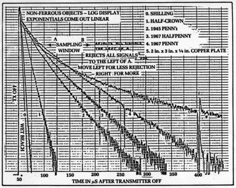

      • Found the coins plot in a magazine article I wrote.
        • Interesting curves. What type and size of coil is used for testing, relative to target size, and what approx. log. vertical scale is, also if any signal subtraction is performed in the process, target-no target condition? I tried with 10in mono, otherwise very fast, and over 80dB dynamic range behind and failed to notice any significant change in decay slope. Actually, decay slope was even less affected by metal target compared to linear high gain amp, by observing just waveform. Maybe i have to retest this.
              Whether I can find my notes is debatable having had many moves in between, Coil was probably 6in D at most. Vertical scale probably 3 decades. This is raw data straight off the preamp with no processing. You should clearly see changes in slope for different objects as in the above graphs.
                  It may look exponential but its not. So even after you plot it on a log plot (so taking the log twice) its still not a straight line (though much close to it compared to the original signal) just another even weaker 1/t^a response.
                  I can see the value in the log-amp for making the process clearer to humans. But the information is still there with a regular amp and I'm not convinced the log amp will match it in SNR. After all the log amp is amplifying least when the signal is strongest... I know as the signal gets weaker the amplification should rise.. but it still seems a bit non-ideal. In a sense your throwing away good signal by not amplifying it as much as possible when its at its best.
                  As far as identifying coins, does the orientation of the coin not have a big effect on its TC ? If it can't identify a coin regardless of how it sits in the ground it's not much help.
