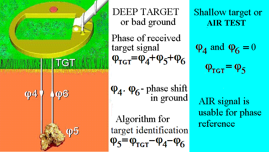

          Here is an illustration what makes the ground convolution with phase information in a CW metal detector. It distorts the response of target. The ground can make so large phase shift of TGT signal that it can enter even in 2nd or 3rd quadrant relative to phase of TX current. This is impossible at air test where the phase response is in the 1st or 4th quadrant only.
          NOTE: The term "convolution" means a complicated integrating math operation in time domain, but this is simple multiplication of spectrums in frequency domain (summation of phases). Search the WEB for details.
          The drawback of conventional VLF metal detectors arise because they use AIR signal or even the voltage across TX coil as phase reference for synchronous demodulation. The method makes correct target identification:
          1.At air test because the phase shifts in matrix are zero,
          2. At good soils because the phase shifts in matrix are relatively small, and
          3. At bad ground, but very shallow target or when the target is on the surface. Participants of this thread make discussion for the last case because nobody speaks for ground convolution.
          At deep target in bad ground, the phase information for target appears very distorted in TGT signal.
          The elimination of GND signal is easy - we must use the GND signal for phase reference and synchronous demodulator can not see it. For this purpose was created the search head with DOoD loop configuration.
          However for deconvolution of TGT signal we should use the suitable software.
