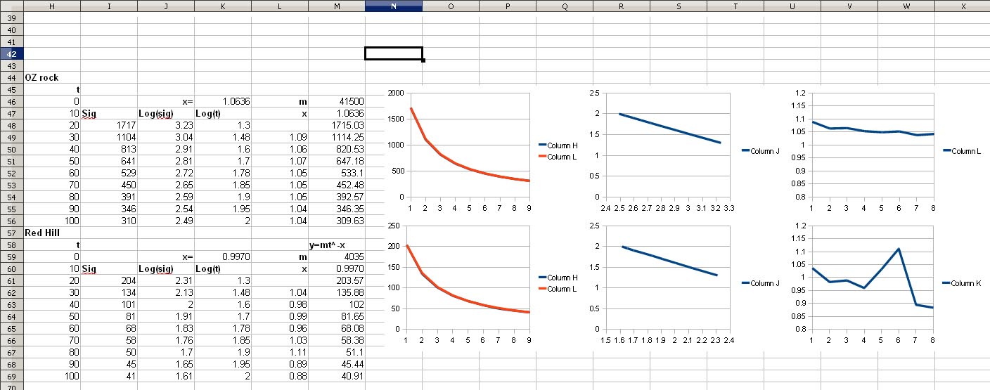

                • Here's my analysis of Eric's soil data:
                  I got very similar results for the exponents, though not identical for some reason. First graph is the data (blue) with predicted curve (orange) overlaid. Second is the log/log plot. But what I found most interesting is in the third graph which looks at the slope between each sequential set of points. Both samples seem to have a definite downward trend somewhat in violation of a the t^-1ish rule in which it should stay the same throughout. Its a small effect admittedly but the question remains is it measurement error or true non-perfect t^-a decay?
                  • Originally posted by Midas View Post
                    Brilliant! That is just what I was hoping someone would do. My graphing does a best fit, so the exponent is averaged over the whole curve, but the fit is pretty good. I always noticed that the 10uS sample was a bit higher in amplitude than it should be and wondered if it was an instrumental problem, but I could not see what was going on further down i.e. change of slope. Now with your results and what I have measured over the past two days, I see that it is not an instrument problem, and I will explain why.

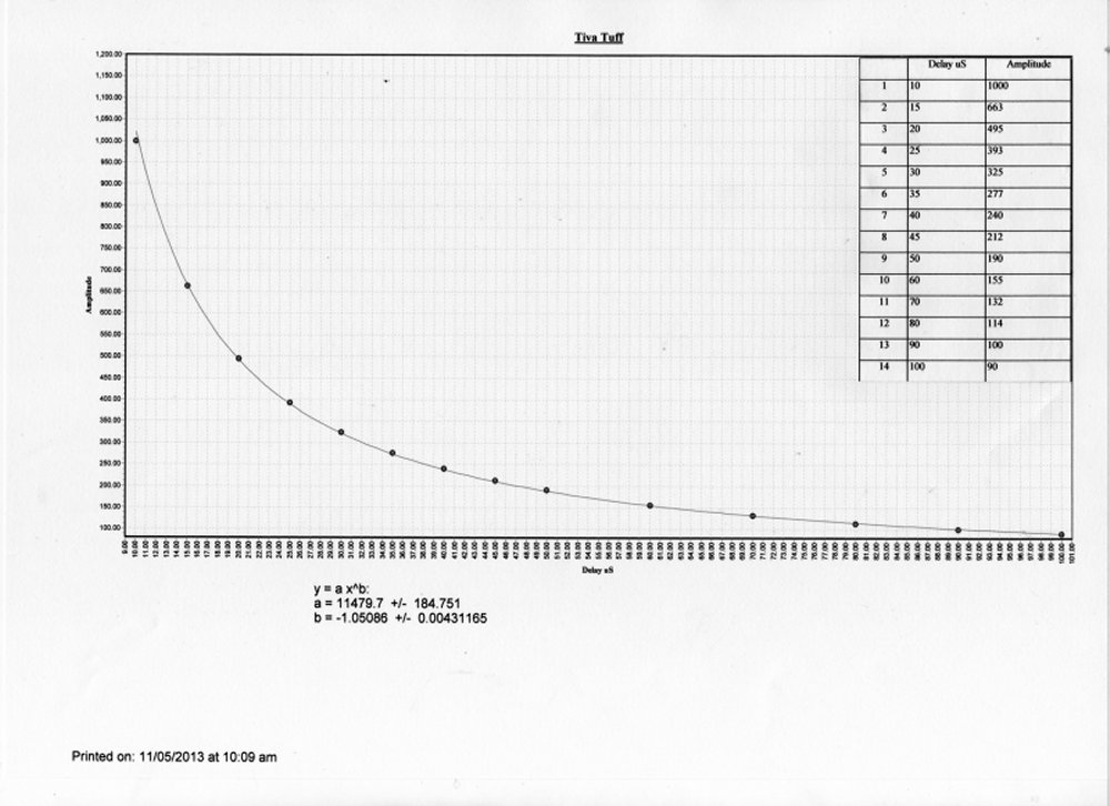

                    Firstly there are no timing errors throughout the range of delays. At the shortest delay (10uS) the clock is running at 100kHz and measured today on a precision frequency meter with an oven controlled reference, is accurate to 1Hz. Likewise, the TX and sample widths are all as accurate. This being so if measurements are taken at 10uS, 20uS, 40uS and 80uS there should be a factor of 2 between each succeeding pair for a slope of -1. e.g. say 500/10uS, 250/20uS, 125/40uS, and 62.5 at 80uS. I also did the intermediate values 15 - 30, 25 - 50uS etc. Having done this I also plotted a downward trend in exponent as you have for the Oz Rock and Red Hill soil. Basically, I took the shorter delay reading, halved it, and divided it by the longer delay reading. e.g. (1000/2)/494 = 1.0121 for the first reading of the Tuff discussed below.

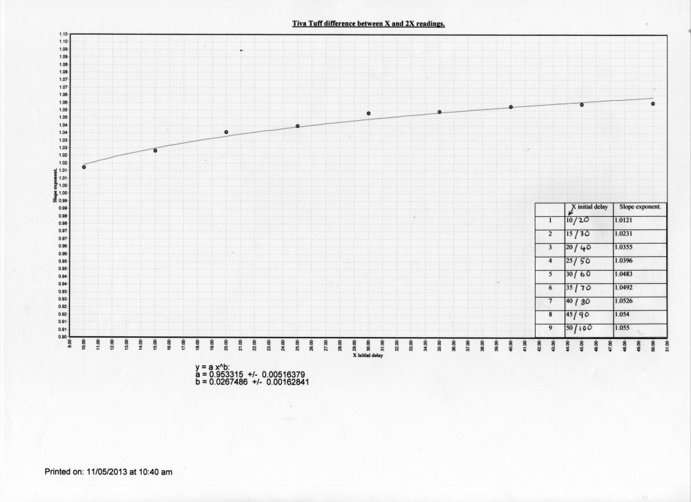

                    Now, it could be argued that there is some, as yet, undiscovered error in the instrument - but for the following. I plotted the results for Tiva Canyon Tuff, which although derived from volcanic ash has some interesting properties. The main one being a very high frequency dependence of susceptibility, >20% resulting in a high viscosity reading relative to its dc susceptibility. With this material the trend of the exponent goes the other way i.e. it increases at late times. To my thinking, this rules out an instrumental error.
                    To improve the S/N figure for the Red Hill and Tiva Canyon material I used 20gm samples instead of 10gm. This almost doubles the signal throughout the range. Theoretically it should double exactly but the bigger pot is poking slightly out of the sensor coil where the flux density will be a bit less. I repeated the measurements a few times and it is consistent.
                    As you say, we are dealing with very small changes here. The Tuff goes from a slope of -1.0121 between 10&20uS to -1.055 between 50&100uS. Plotting out the full results for the Tuff and doing a best fit curve, it almost looks as though the exponent has its own power law of +0.026.
                    Eric.

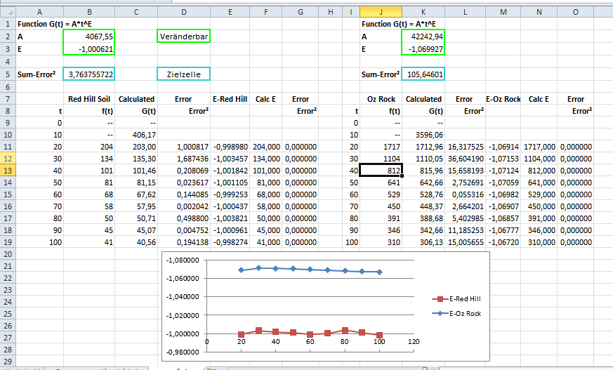

                    • Hi all,
                      this is what I get. It seems, that the "extrapolated" exponents (with least error to the measurement) doesn't correlate to each sample timings so it is very likely a normal and noisy measurement. I don't see a significant decrease of the exponents (see below).
                      Please, feel free to experiment with the Excel table (see below).
                      Decay_Eric01.zip
                      Cheers,
                      Aziz
                        Hi all,
                        this is what I get. It seems, that the "extrapolated" exponents (with least error to the measurement) doesn't correlate to each sample timings so it is very likely a normal and noisy measurement. I don't see a significant decrease of the exponents.

                        Here is the one that bucks the trend and gives an increase in the exponent with time. Noise not a problem even at late times and integration time longer than would be for a PI detector.
                        Eric.

                        • Hi Eric,
                          ok, I have checked the point, that you fit the exponent between two readings (Amplitude(t) = A1, Amplidute(2*t) = A2). Is this correct? Or how do you calculate the exponents in the last picture?
                          If I have understood it correct,
                          (1) B*t^b = A1
                          (2) B*(2*t)^b = A2
                          solved 1+2 for b:
                          b = log2(A2/A1) = log(A2/A1) / log(2)
                          But if I put the parameters into the formula however, I get different values.
                          Aziz
                          • Eric, for reasons I am not at liberty to disclose, I regard your interpretation of the Tiva Tuff data as correct. (However, this is a poorly understood area of magnetic physics and I may be wrong.)
                            --Dave J.
