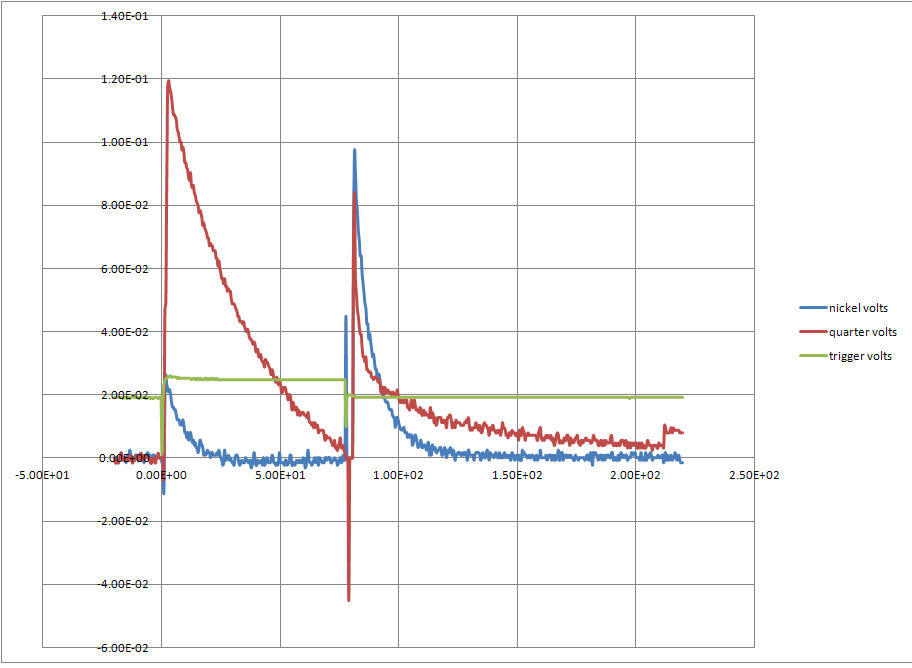

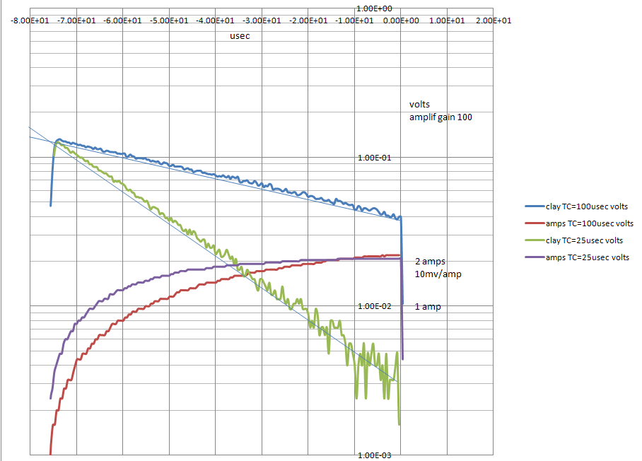

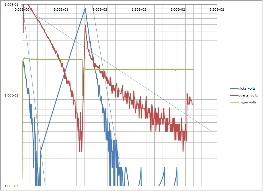

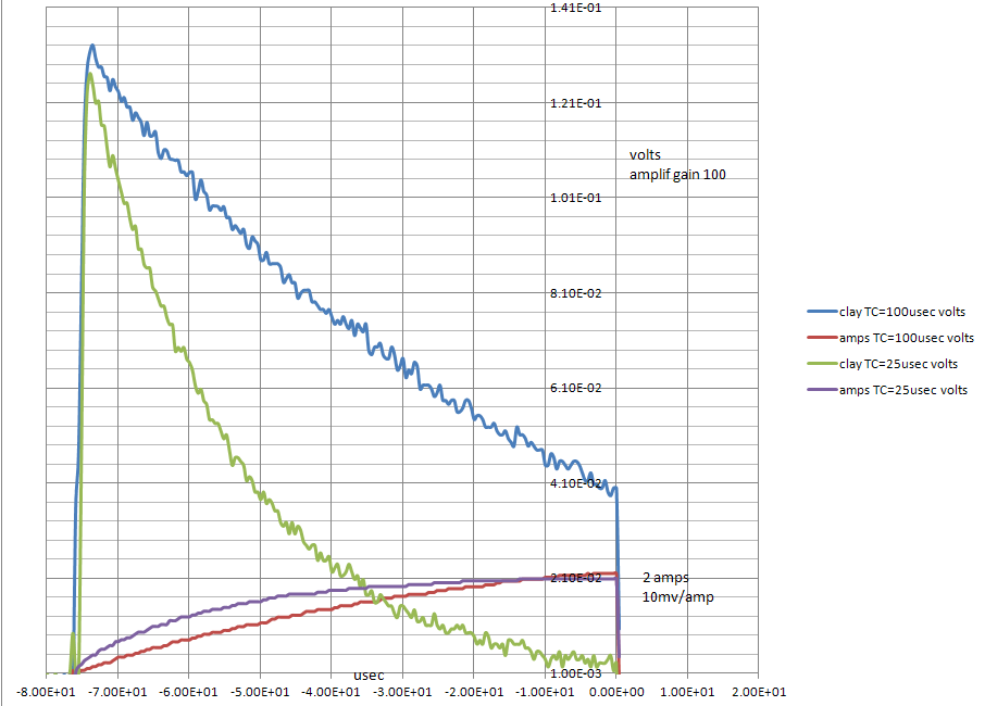

  • Plotted a nickel and a quarter during on and off time. The slope for the nickel is close, the quarter not. Forgot to divide by 5 for the ground TC above post.TC 60 usec for the clay and lava during on time.
    • Interesting graphs.
      Instead of looking at the trigger voltage, looking at the coil current during ON time, will give much more information. The TC of the target becomes apparent and you can see the difference in eddy current amplitude with different coil TC and target TC.
      • Originally posted by Monolith View Post
        Interesting graphs.
        Thanks for the reply. I've been wondering if I could discriminate ferrous/nonferrous looking at on and off times with a PI. I was trying different targets, coins and nails and it was looking promising when I tried a nickel. Flat was ok. On edge looked like nail. Then I noticed it was a Canadian nickel. Clay from yard causes a large signal during on time and would have to be ground balanced. I'm wondering if other grounds decay with a TC during coil charge time and what amplitude difference I might see between on and off times with severe ground conditions. Tried different coil TC by adding resistance in series with coil. Changed signal TC.

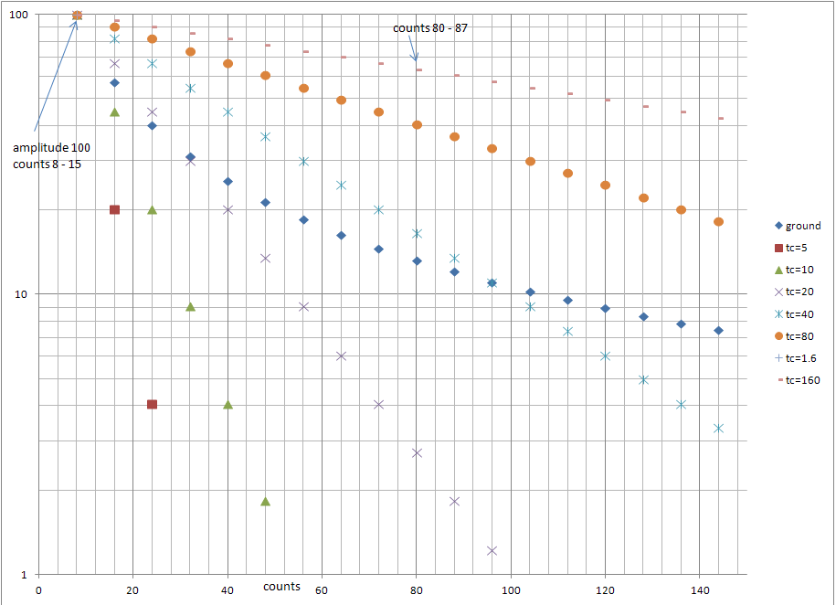

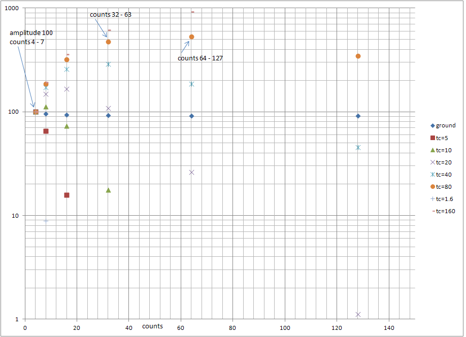

          • I plotted some decay curves in excel. Not sure if they are correct or make sense. The amplitude for the first sample starts at 100. One plot doubles the integration time each sample. The other plot integrates equal time each sample. I think the plots show where the holes are if you do ground balance. The sampling is done in binary steps. I'm thinking the curves are valid for any clock frequency. Four counts equals 5 usec, 8 usec, 10 usec etc.

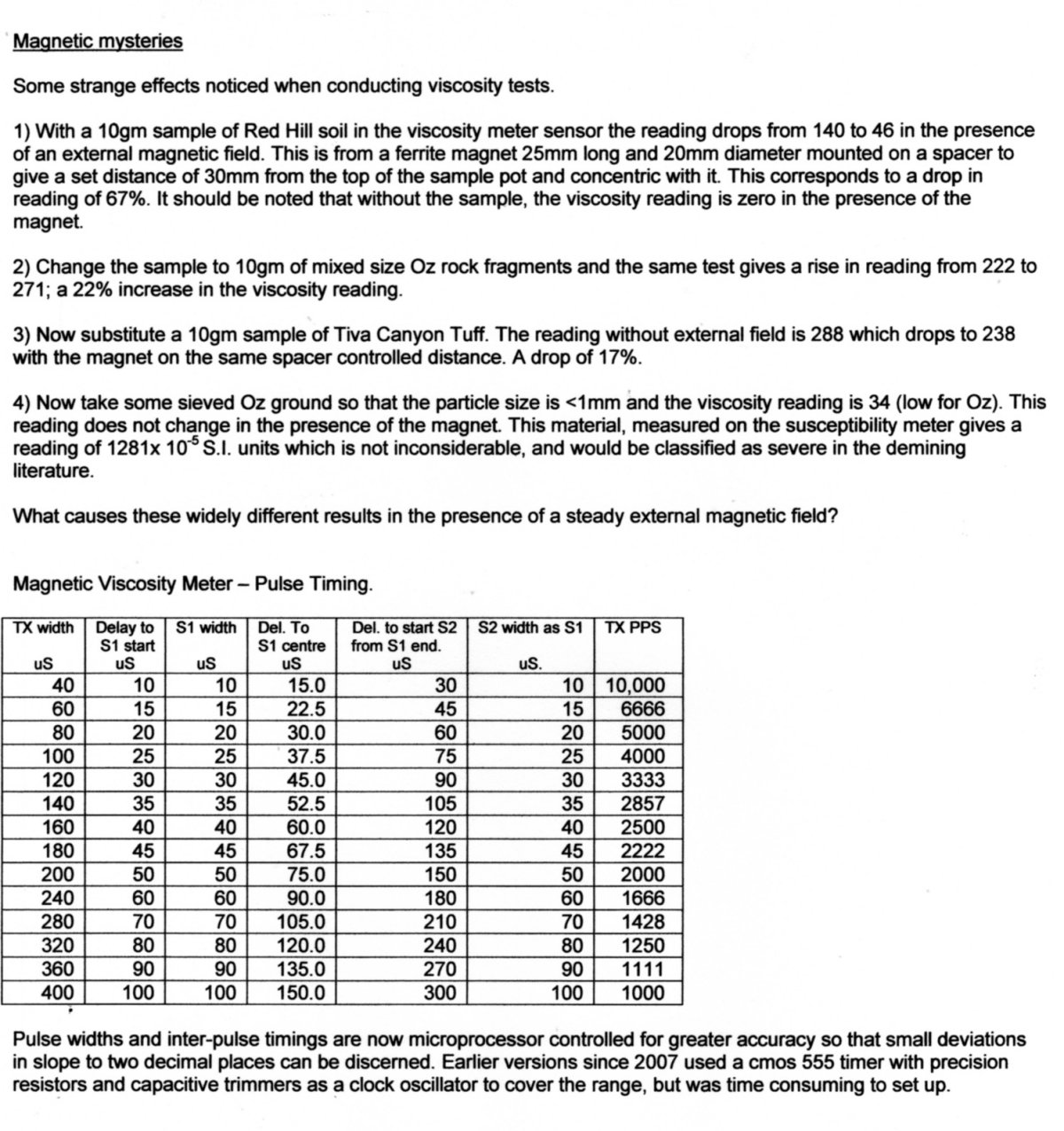

                    • Viscosity Anomalies
                      Having done a considerable number of measurements on magnetic soils, and latterly with greater precision, a few questions emerge regarding the behaviour of different samples. There are also small differences in slope between some samples which are noticed at early times and this could be due to differences in grain size distribution.
                      I reproduce a page from my notes here to stimulate further thinking, as the fact that there are differences may impact GB filter design.
                      Eric.
Name:	MVM anomalies003b.jpg

                        • Referring to Eric's post #400, the reason the Tiva Tuff viscosity drops in the presence of the external magnetic field is because Tiva Tuff is impoverished with respect to SP particles. The external field pushes the behavior of the SP particles closest to the SD boundary into SD behavior by pushing the BH curve harder into the saturation region.
                          --Dave J.
