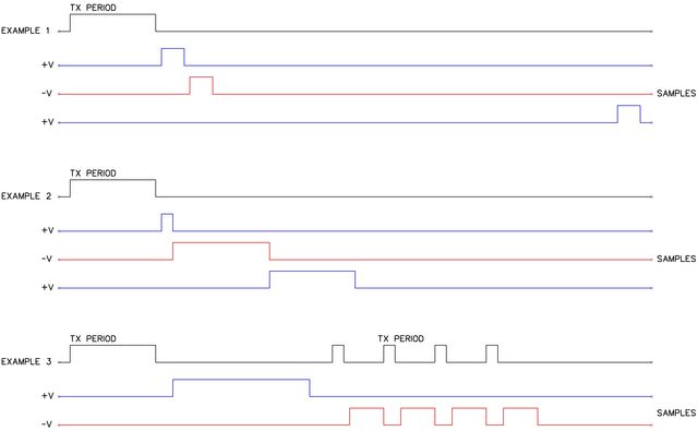

      I have included a JPG showing 3 types of sampling routines for ground balancing,each have there advantages and disadvantages.
      Now which one manages ground variability the best ?

        Well, Zed, can I have a crack at this??
        Example 1 is Pool's method as used by Foster, Bosnar, etc. Advantages ?....Disadvantages...sample 2 must be amplified.
        Example 2 is Minelab's IP. Advantages...Doesn't require amplification to obtain GB, and doesn't subtract as much of the target signal.
        Example 3 is a very poor variation of Minelab's IP. Has a slight auto GB effect.
        Bugwhiskers attempted to patent example 3 in his original patent, and one would therefore have to wonder if he understood what he was doing.

              Well Urbanfox in example 2 the third sample is shorter than sample 2 and so the samples will cancel static fields when an equal amount of gain is applied to them,the m/lab patent that you refer to has a third sample thats longer than the second sample in which case the samples wont cancel static fields when the same amount of gain is applied to them,in order for the m/lab samples to cancel static fields m/lab need to use scaling on their samples,the example that i have given no scaling is required and so in my view my example does not constitute m/lab IP.
              And yes the second example does cancel out less target signal and manages ground variability better.
              The third example was not intended to demonstrate a precise example of anyones sampling routine but rather to bring to light an alternate method of achieving GB,further more the third example is the one that performs the poorest when it comes to managing ground variability.
              Now i have a question for you !
              How many people know that the third example is m/lab IP considering none of m/labs patents actually show this method of taking measurements ? Your post 63 would suggest to me that your an employee of m/lab.

                You will find App No AU199047963, Pat. 633536 discloses the method in Example 3.
                Re "How many people know", I ask how many people read the patents, and then ask how many people understand the method?

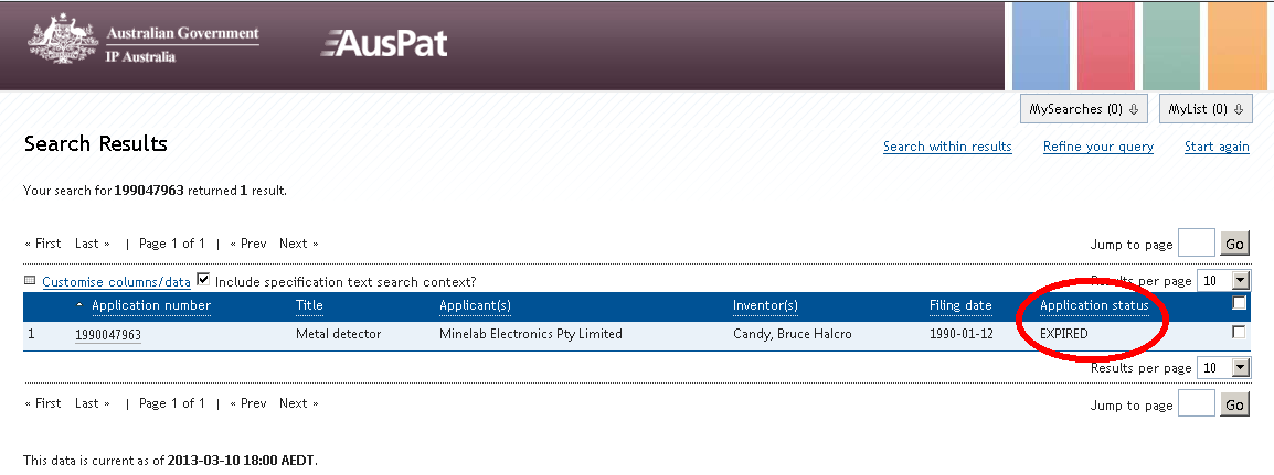

                  Au1990047963 is not available for viewing in Auspat so how do you know what is in it and I cannot find 633536?
                  dougAEGPF

                            Ferric, don't mind UF appearing here. Trolls do that. And nothing useful. Ever.
                            It is because it's expired.
