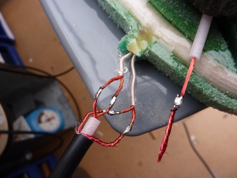

                    The patent mainly applies to pi designs that sample early where excess metal in the coil housing will respond as if moving relative to the coil when the coil passes over certain rocks and ground. You can test a few short length of soldered wires by passing them over a properly made coil. If the PI responds then a coil with similar joins will have you digging false signals in highly mineralised ground.
                    I think Carl is talking about using ferrite to rebalance a coil? Not the same thing.
                    Sure there is no problem with balancing a mono, however excess metal must move against a coil to become detectable. Good luck finding anything with a coil with moving entrails! In case all the poorly welded joins with excess metal on them is used, there will be a minuscule rise in response, but a cyclostationary rise with no consequence for detection. To be able to deteriorate noise you'd need something noisy, which soldering alloys are not. The relaxing magnetic domains are noisy, and the effect is called the Barkhausen effect. Ferrite is not known for Barkhausen effect, but is prone to saturation. This saturation is prone to modulation with earth field, acting as a magnetic amplifier.

                                Let's get back to the theme of this thread as, like times before, threads get into a free wheeling mode and self destruct. Minelab have a particular problem in that their coil design relies on a very low resistance winding and cable. This means that the equivalent wire gauge is quite low (16AWG?). Joining the coil wire to the coax by means of an overlapped solder joint is impossible to do without producing, even with care, a blob that is detectable. I have just done it with a ML coil and ML cable. The coil is the TX half of a dud 11in DD now used as a mono and connected to my PI viscosity meter to give a digital readout of signal values.. The single joint is detectable at the centre of the coil at 10uS. Bring it close to the winding and the signal is strong. Put a ferrite sleeve over the joint and signal disappears. Place the joint in the centre of the coil to get a signal; pass a piece of solid magnetite rock over it at about 1/2in and the signal increases. Place joint on the coil winding and the magnetite causes the signal to decrease - just what you would expect from the different field directions and what the proximity of a permiable object would do. So for ML low resistance coils, the type of cable they use and where the cable/coil joins are positioned, the ferrite sleeve appears to have value.
                                Are there other ways of achieving this without the use of ferrite sleeves? First thing is to position the joins (solder blobs) away from the coil centre and upwards from the coil winding. I used a 2in long plastic extension at the position where the coil leadout and strain relief is. The join is in this extension which is then 2in above the TX coil winding. This is sufficient distance for the solder blob to be almost out of range of any modulation by the most aggressive "hot" rocks.
                                Another way is to split the joins as shown in the picture. Comparing the signals at 10uS delay the split join gives 1/20th the signal of a full join. The fact that there are now 4 joins instead of 2 makes little difference.
                                For normal PI use this whole thing is a bit academic, but if you are wanting to get below 10uS to, say, 5uS delay then at the shorter delay it will become important. However I would not be using heavy coil wire and cable, but something much lighter and with very much smaller joints. As I have mentioned before, the more important feature of short delays for small gold, is the big increase in viscous ground signal
                                By the way, I have used large half pot cores on which to design a detector that has the detection field just on one face. This was a industrial design that had mechanical moving parts behind the coil, and to prevent modulation by them. Also behind the pot core was the electronics and cable joins so that these were not detectable. One application was for companies cutting up chipboard, so as to prevent damage to the saw on bits of chopped up nails and wire that get into the raw material. Also, a head of this construction was made as a small coil for detecting beneath wire fences. The pot core in a metal box that I mentioned a couple of days ago was a real project, in case anyone thought I was being frivolous. Had to bolt a sensor on a railway line to count the number of wheels that went past on a freight train. Just a half pot core peeping out through a hole in an aluminium box, to prevent detection of the rail it was bolted too. Now there is a question - why would anyone want to count wheels on a moving train?
                                Comparison of Bifurcated Joint Technology with Single Joint Technology
                                Eric.
