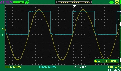

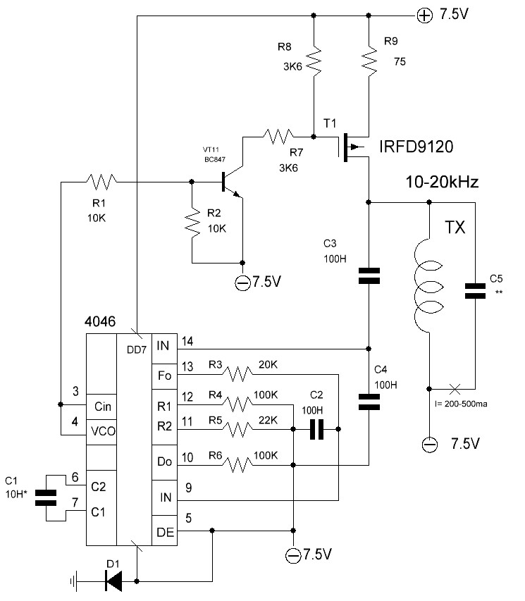

                    My version of the generator TX. More linear than working on a bipolar transistor. Accelerates more power. Field key to better themselves showed.
                    Current consumption from the power supply of about 20-30mA

                      Very nice . Glad you like it . Somehow I stuck in something else and never got to making the thing myself, but I like your results very much. I have a few BS250 and may try your solution first.
                      Anyway, did you notice the version with 2 flip-flops to generate quadrature drive and Tx coil locked oscillation simultaneously? It could work for Verator better than the current comparator's phase shifters. You require quadrature drive for Rx, and what better quadrature than one produced by the very oscillator, and with perfect 50% duty cycle. It will be completely phase noise free.

                        Works very well BS250 better and do not. R9 is better to put the 150-200om High linearity

                          Yes, I thought of suggesting you to increase R9 as it both increases Q factor and decreases power consumption. With better Q comes linearity. Too much R9 decreases amplitude.

                            The difference between 75om - 200om amplitude of 5-7% but current consumption decreased by 10-15%

                              It is related with coil Q. R9 presents itself as a shunt resistor of double it's value (50% duty cycle) and it reduces the Q factor. Once you use a value that is near the equivalent shunt resistance of a tank, the changes are very little.
                              Did you plan to try the configuration with flip-flops? They are producing quadrature outputs by means of Johnson counter configuration, and produce 100% accurate quadrature regardless of oscillator frequency.

                                Apply trigger divider can be but with the condition that there will not be through the phase shift. That is, a frequency divider. It is a known issue.Adopt Dividers can. But I'm not interested because I can not influence the attitude 0 \ 90 Generally there is no problem with it.
