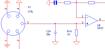

            Yes, it's true. I agree 100% Parallel circuit I use a LPF filter because the high harmonic content of the signal transmitter. When using a serial loop then a lot of debris. This solution is more suitable for sinus transmitter. But due to the large dynamic range Verator withstand any inclusion. There was no difference in the work I have not seen. To make the initial contour line Garrett uses the input RC filter loadClick image for larger version

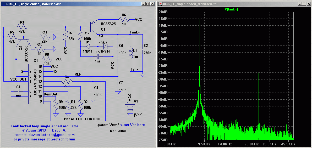

                          I would like to ask whether it is possible to receive in the mail a model for LTspice PLL4046. аsy
                          • #88
                            Here you are, a new development. I moved some parts here and there so that signal path gets compensated delay - the invertor is now inverting the comp_in signal instead of the coil drive. This way any delay incurred by transistors switching is mutually compensated.
                            You'll find in a zip file both .asc and .asy of a 4046, and a working schematic that utilizes them. This is a hierarchical model, so instead of a library, a 4046 is designed as a sub-schematic. It works pretty close to reality.
                            Enjoy

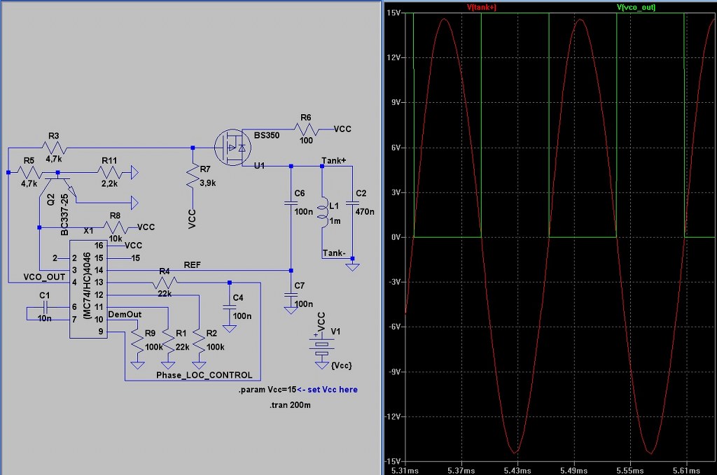

                                slightly improved. Click image for larger version
ID:	337262Transistor BS250 (!)
