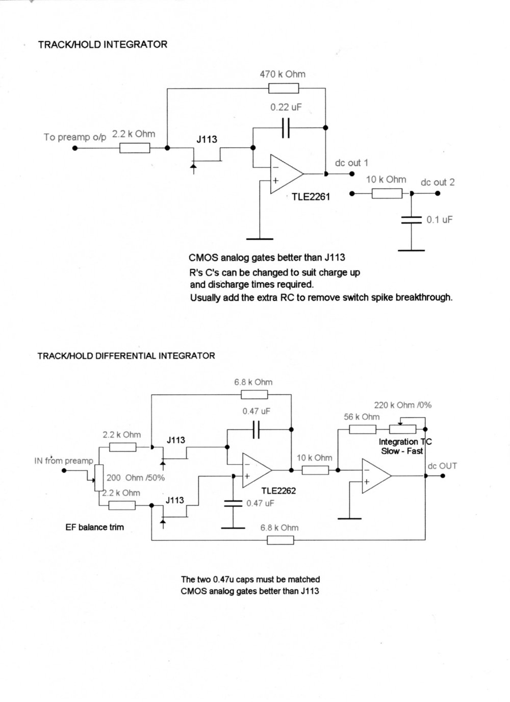

    Here are a couple of alternative arrangements that I have used from time to time. The differential version is interesting as it enables you to change the integration time with a single pot. The track/hold arrangement prevents the voltage droop you get with the more common "leaky" integrator where there is a high value resistor directly across the cap.

    Eric,
    Thanks for posting these circuits.
    I always wondered what the function of the other amp was for in the second drawing. Any results from the VCA log amp? I received mine, but they are surface mount so they need to be mounted on an adaptor. On the to do list.
    Mark

        Basically the second amp just performs an inversion so that you can feed back to the + input of the first amp to keep things symmetrical. However, by giving it a bit of loop gain you can alter the TC of the integrator.

          Hi Eric,
          Thanks for posting these. Can you tell us what the advantages are of avoiding 'voltage droop'?

              Precious little in reality. Just for the purists. The differential circuit's main advantage was the ability to slow up the response in noisy EMI situations. This was used in the Superscan detector.
              I don't use either arrangement now as matching the two sets of RC components was always a pain and you get a far better performance by summing + and - signals into a single TC integrator. More on that later.

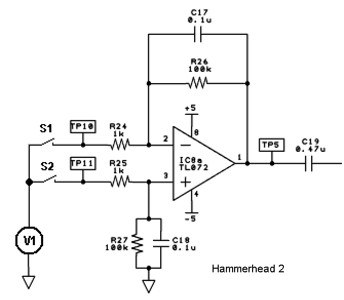

                      Now read what is written for integrator in Hammerhead:
                      For the differential integrator to work properly, both sampling pulses need to have the same pulse width, so both pulse width monostables (IC11b & IC12b) are controlled by the same RC time constant, R46/R46a/C26, by using isolation diodes D6 and D7. This scheme*) works nicely, as long as the two pulses have a sufficient amount of delay time between them, which is easily met in this application.

                      *) Suggested by Eric Foster.

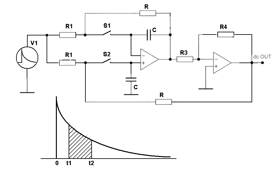

                      Here is the principle:
                        The lower diagram illustrates what an integrator calculates . This is a DC voltage proportional to an area. The calculation of area starts at moment t1 and ends at moment t2.
                        Let we analyse the circuit diagram.

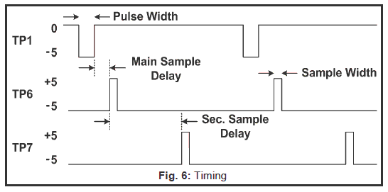

                        What is timing of switches S1 and S2?
                        What calculates the "Track/hold differential" integrator?
                        What information we need for target?
                            A typical example is S1 closes after a delay of 10uS from TX off and stays conducting for 10uS. There is then a further delay of maybe >100uS before S2 conducts for an identical period of 10uS. The repetition rate rate of the TX/sampling cycle may be anything from 200pps to >3000pps, depending on other factors of the detector design. This type of differential sampling cancels any offset from a dc coupled preamp, waving the coil in the earth's field, remanent magnetism in hot rocks, and LF interference from power lines. Differential signals obtained from sampling a decay curve are not cancelled, although the S1-S2 timing may have to be increased to avoid partial cancellation of long TC objects.
                              Of course , the main problem in the classic PI design is the decay curve itself . And the worst thing is that this curve ( and its integral ) can depend on many factors . This fundamental problem which cause DC instability of the whole device ...
