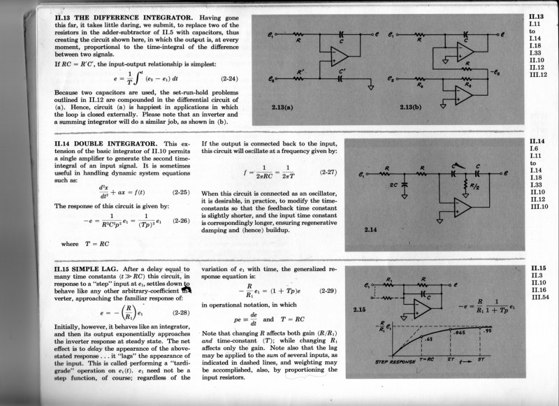

          From Mike "the design of an electronic device should start with analysis what is the most suitable block diagram". This was all I needed to see in 1966, a building block to perform an operation that I wanted. Then it was straight to the bench to try it out - and it worked. No long pages of calculations; that comes later when you want to find out how to optimise it. Even so, many things can just be tried on the bench much quicker.
          Eric.

                Hi Eric, I tried the first circuit from your first post and compared it to the standard method if integrating. I noticed with my long sample periods the output was a-lot smoother using the track/hold integrator. More testing needed.

                  Eric, the name of this block is DEMODULATOR (see my previous post) and this not an integrator, but specific case of sample - hold circuit. The DC output of this demodulator represents the "color" of target, but it is calculated by only two samples. This is not the best design solution.
