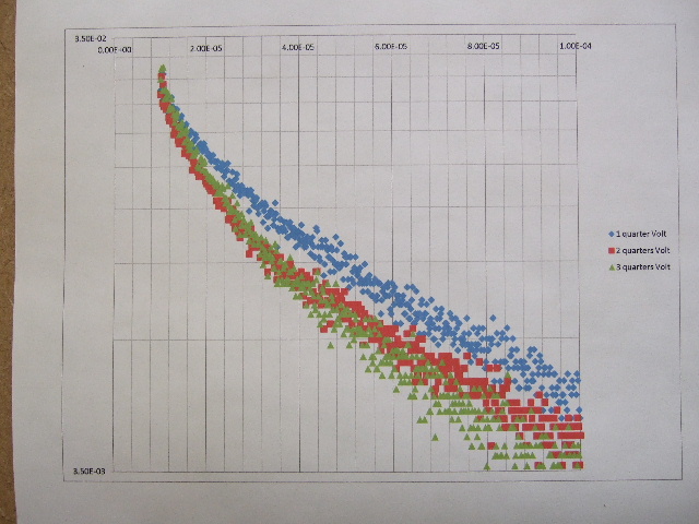

            What Carl said. I stacked nickels, 2,3,4,5 touching and insulated in a four inch coil. Five nickels more than doubled the TC with less than a 10% increase in amplitude

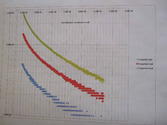

                I tried the test with 5 quarters. Got different results. The single coin had a slightly lower voltage at the start but a higher voltage at longer decay times. I still don't have my preamp done and am looking at coil voltage after the decay with a scope. Subtracting a no coin reference signal from the target signal in Excel. The coil is laying on the bench with the coins stacked on the bench in the middle of the coil. Should I expect result to be a lot different measuring the coins at a distance 1,2 and 3 times the coil radius with a preamp and integrator?

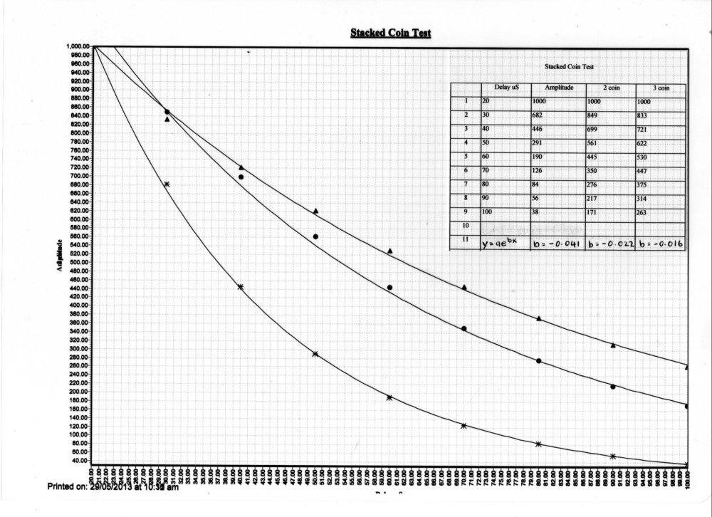

                      Here is a plot for the three coins. Lower curve is 1 coin and show a good single exponential. The starting amplitude is set to 1000 for each of the 3 curves, although the exponential fit for the second curve (2 coins) was at some variance, particularly at the start. For 3 coins (top curve) it is better. It demonstrates that as coins are added to the stack the TC increases even though they are insulated from one another. I am not clear as to why.
                      Tomorrow I will post a different graph set showing how the starting amplitude varies as coins are added.
                      Eric.

                        Mutual inductance rising more rapidly than resistance falls? The contacts between coins are likely to be a different magnitude of resistance compared to the skin of a single coin, too?
                          Probably you need to add some EM shielding from side of stacked coins. Could be that some of composed pulse spectrum penetrate insulation.

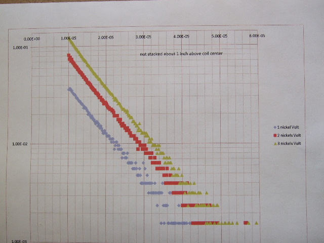

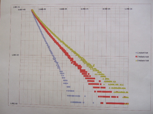

                            4 inch coil, coins centered in coil, not stacked coins were touching, not stacked nickels about 1 inch above coil center, stacked coins were touching. Plotted difference of no coin reference and target. Noisy but still shows trend.

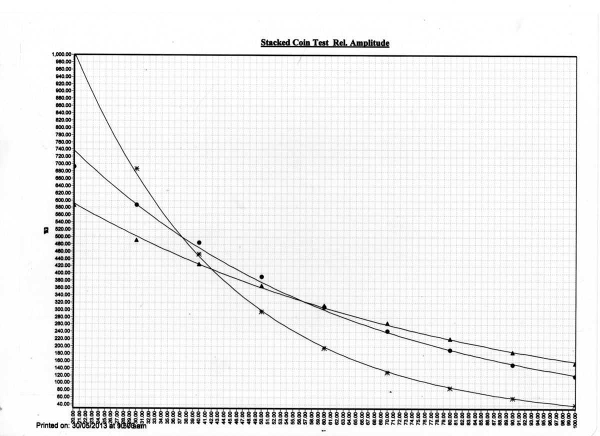

                              Nice plots . I expect the results will be rather different for other coins, particularly coins that are made of a more conductive metal e.g. silver or copper. Each coin in turn is attenuating the high frequency components of the TX waveform, giving less excitation to the next coin. Lower frequencies still get through to give the enhancement at late times. Star = 1 coin, Circle = 2 coin, Triangle = 3 coin.
                              Here is a further plot for my coins where you see the initial amplitude reduced for the next coin in line, but the enhancement at late times. I am hoping that some brave person will try a Spice simulation - if it is possible.
