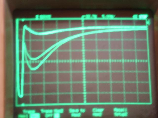

                              Here's some screen shots taken using 200us TX pulse and frontend gain of 100x, the targets are 50c AU coins. CRO set to 10us per div.
                              No Target.....
                              50c AU coin.
                              Two 50c AU coins no spacer.
                              Two 50c AU coins using a piece of A4 paper as a spacer.
                              Two 50c Au coins with a 5mm spacing.

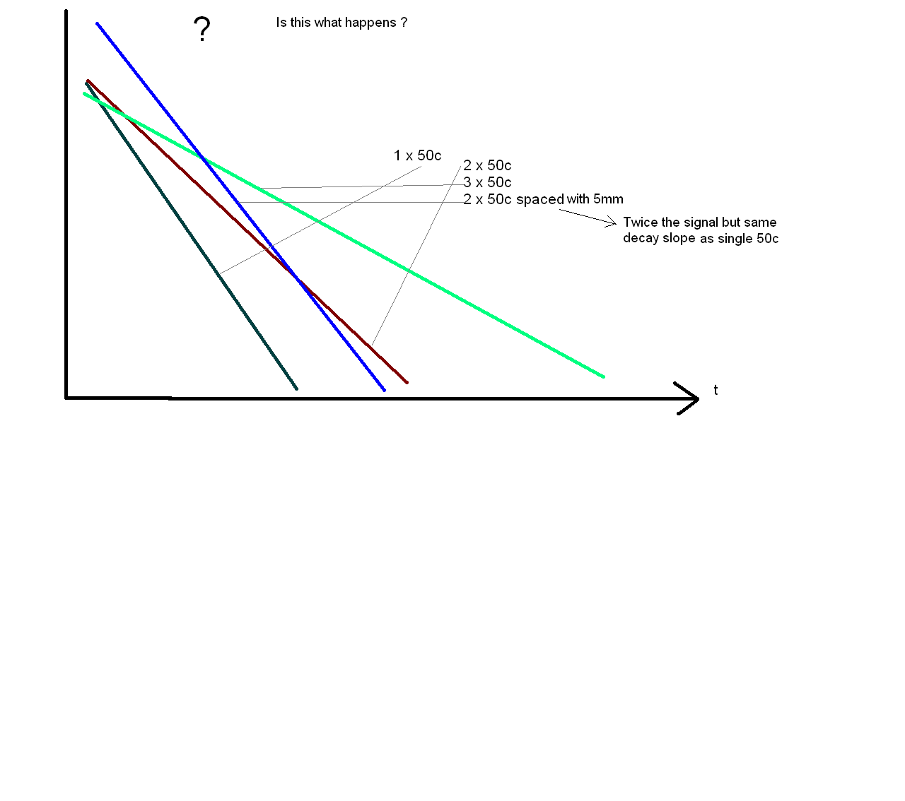

                              • #45
                                So is this what is happening ?
                                If this isn't happening, then I am lost.
