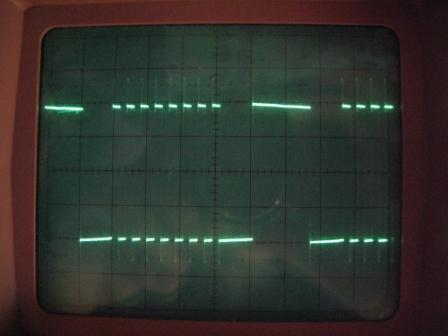

                          The basics of the Tx drive look fairly simple on exp2 i.e. fast, not so fast and slow and back.
