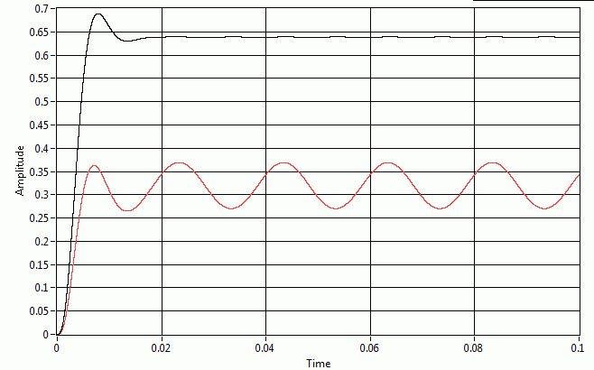

        I made a simplified simulation in LabVIEW. I generated 10 kHz sine wave with an amplitude of 1 and added a 50 Hz sine wave with an amplitude of 0.1. Then made the synchronous rectifier single / full and 100Hz low-pass filter. The output from the filter graph:
        red - half-wave rectifier,
        black - full-wave rectifier,
        I'm not 100% sure for the accuracy of the simulation but the chart suggests itself.

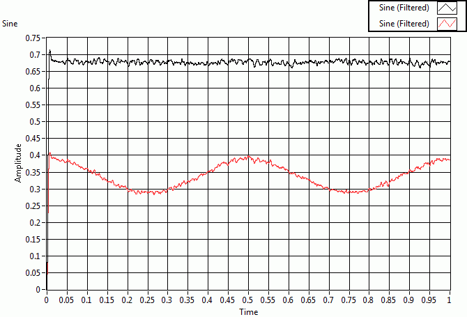

          Taking all risk to be incorrect, or at least misinterpreted on this, my answer can be: Only really important difference between half and full wave demodulator is, half wave is like SSB (single side band) and full-wave is like DSB (double side band suppression) in normal communication technique. Only, here IF is centered around zero and followed by very narrow band high gain motion filter stages. As a result, half wave SSB suppressing type will leak part of low frequency component (usually ground proximity generated but may come from other sources too) within filter bandwidth, directly to next stage , full-wave will reject it. Nothing to do with ground balance, just demodulator output DC or LF level will change more or less. Full wave is better, will not leak, other considerations, like noise, interference, distortion etc are less noticeable and important.
          Just try to simulate RX plus some component within few Hz effect to output after filter, you will see difference. Use full wave, not some dramatic change, but better.
            The same simulation but with 2 Hz noised modulation.

              Consider the output voltage and ripple characteristics of half wave rectification versus full wave rectification of AC off the mains.
              pepe's simulation pretty much shows 2X for full wave and substantially reduced ripple.
              That should sum it up nicely.
